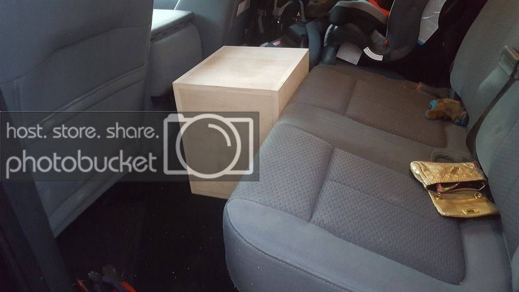

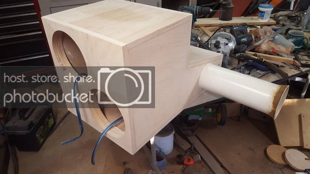

Have you checked to make sure they will work down firing I suspect they wont. Remember the surround sticks down pretty far and with .62 inches of excursion you will need your baffle at least 2.5 inches off the floor honestly probably more considering how the box sinks into the carpet and deadening a bit. I just installed 2 of those subs in mine and after breaking them in absolutely love them. I took cscstangs advice and did them front firing with a aero port close to the door tuned to 35hz. My box only has two and wont work for you but here is what I did I still need to finish it maybe a cup holder I am not sure.

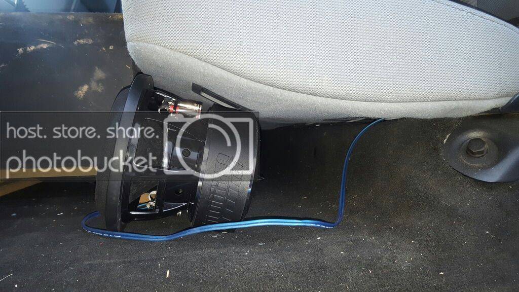

I did a 10 up firing and down firing. It sounded much much better down firing. I run the sa8 v3 front firing and they play very low and loud. I dont think you have another option for under the seat I think that massive little 8 will only fit under the seat facing forward. Here is a picture of mine with no seat lift. Its hard to imagine with an extra 2.5 it will fit rear firing. How did you go about lifting your seat 2.5 inches?

I bought a 2.5" seat lift kit from LMI welding online, it was very simple to install and looks good. I'm working on loading up some pics (I keep getting error codes so bear with me), so you can get a frame of reference, but it actually made a lot more space down there in comparison to factory height.
