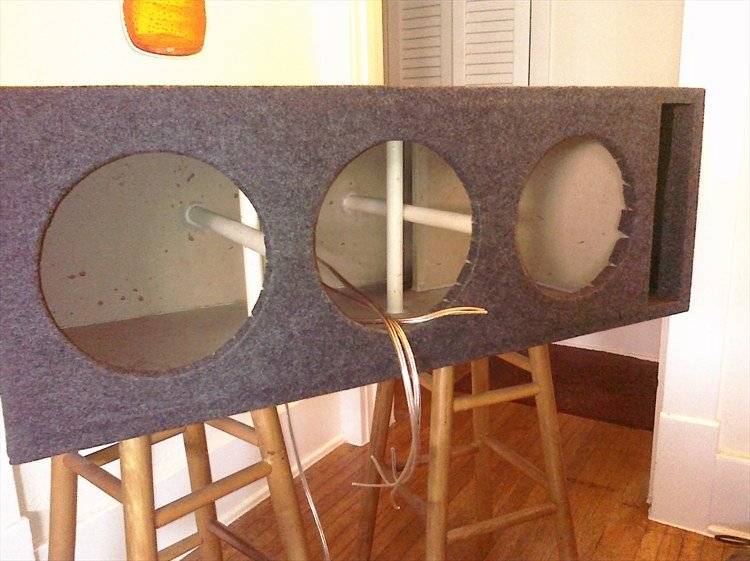

This is how I like to do it:
appreciate the pics bro. im going to to try to build mines like the 3 sub box you have since mines will be a similar type of enclosure and see how that works. im guessing by the pic i dont need to brace the sides then huh

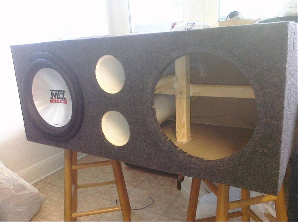

I keep seeing 2x2s mentioned, can somebody show me an image of these being used because I don't know what it is and can't picture a 2 inch by 2 inch piece of mdf being useful.
^^^yep 2x2 is just a 2x4 cut in half. Its the size of the rough cut before the piece is ran through a planar for smoothness. Its really only 1.75x1.75iirc. I like to use 1.5in oak dowels but they are kinda pricey and pine 2x2 is 1.50 per 8ft by me so I gave 2x2 a shot on my last build as seen above.
