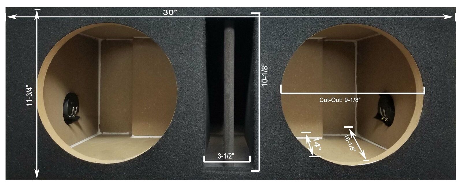

Couldn't wait... bought the box. Here are the dimensions.
That box is roughly 2.4 cubes before port and speaker displacement. That seems a little small to me for two of those 10's. That box says it's separate chambers also. Interesting.
Slightly smaller than what RF suggest at 1.4cuft per sub. I am ok with that, I want these to shift up a bit from the box I have and play slightly higher sub-bass.
That's 1.2 per sub, but you still have to subtract the port displacement. It's tight, but if Buck says it will work, then, it probably will. He's the professional.
We will know soon enough lol. The space in my trunk is also kinda small and this box will still fit in there. I think it's gonna work fine. I have another single 10" enclosure, the labyrinth slot port box. It's pictured in my SQish build thread. It's smaller and tuned much higher than the bigger box I replaced it with and the P3 played higher in it which I prefer. It still hit low notes just not as hard, which I don't mind... a second 10 will help that ;)
