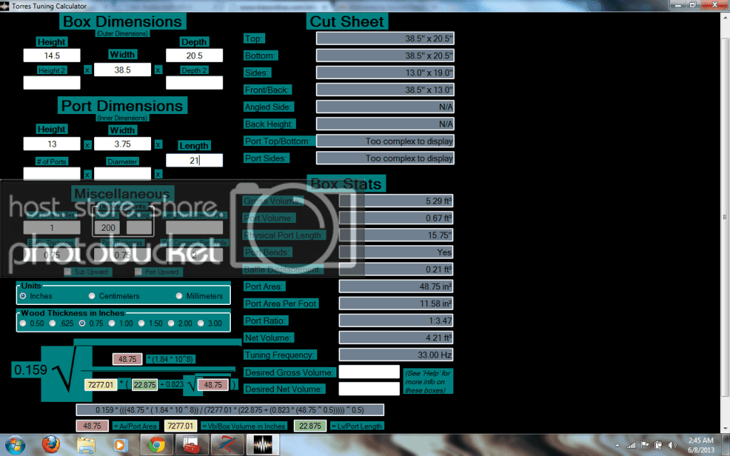

I threw together a basic dual ported enclosure on torres using this as specs: Link = http://www.treoonline.com/infosheets/ssp_subwoofers.pdf
I entered in .200 for sub displacement being that you will be using 2 to get an accurate net ^ ft, Double .75" baffle for the face, subs front / port front (torres default) - This should work, I like tuning to around 32-34hz (Just my preference) and ppl all have their preferences when it comes to tuning... - Anyway here is a basic layout of a dual 12" slot ported enclosure...
