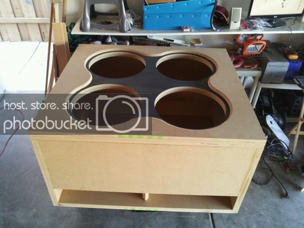

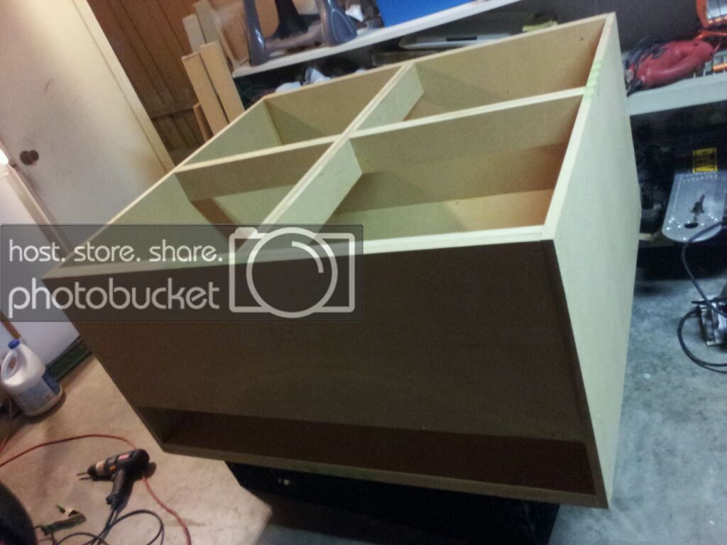

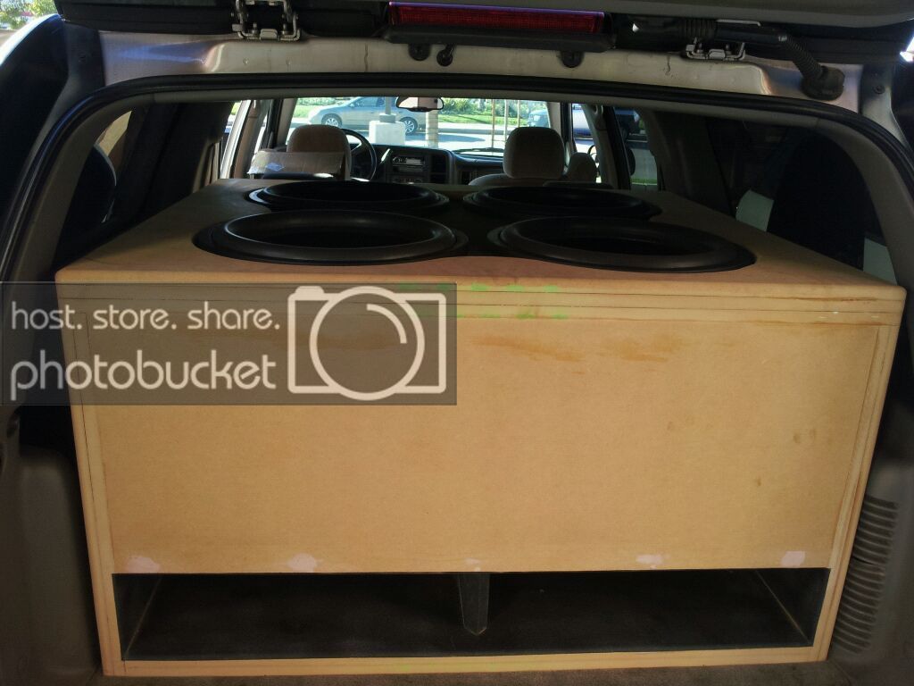

ok guys i been looking around on a couple forums and i cant find anyone who has made a box for 4 dc level 4 18s m2s im gonna be powering them with ab 750.1 im in a astro van..so space for box isnt issue i think im gonna get this box made these aren't exact specs but pretty close to the box i would get made unless proven otherwise for a better enclosure ..
i dont want only lows i dont want only spl io want a blend of the too!
49"w x 44"d x 27" h
recommended 23 net, tuned to 33-34 with 310" port loading off back hatch
heres pics of the box specs i have above im copying a buddys box
good for an suv ,prolly not an astro van tho .id this a spl competition or daily ?
daily but i do go to comps but im not chasing numbers would mind a 52 lol but if i dont get it i wouldn't be mad rather me musical then burp orientated ...what makes it good for suv an not for van what makes it better for a van?
not sure ,but it may be just the inner dimensions of the vans .the subs up port forward tend to be louder ,unless doing a wall,which is best in the astro van .i've seen subs and port forward as well and its very loud that way to .
do u have any links so i can see what u mean by that? cuz ive been told with boxes no walls ..bottom port loading off back hatch gets loudest but i have no way of knowing theres not too many astros running no wall..or if they are there for spl and throw the box were the middle seat is
try to get a hold of jeffery fernandez of so cal spl he could give you some tips on a no wall system for the astro van
