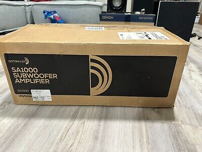

id build a new box for it and get a plate amp. sell the rest. heres my ht sub. got a 1k Dayton amp on the back...
If the amp is already part of the unit, with the amp built in, you would need a power supply, something like this:
Amazon product ASIN B0BC9NL42B
Or sell that amp amp and replace it with one of these 500 watt plate amp w/DSP:
