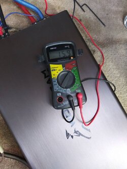

Correct. set the amp at a 1 ohm load and you won't drive it as hard. Just because you don't have the electrical to support it right now doesn't mean you can't set it for a 1 ohm load anyway....just be cautious and take it easy with it until your ready to upgrade it.
When gain setting, everything has to be at 0 or flat.
This is my 4 ch amp. I set the gain on it the other day with everything flat or turned down to 0 and played a 1000Hz tone. I got pretty close to the target voltage, doesn't have to be perfect but the closer the better...
Did the same thing with my mom amp yesterday...no pics tho.
