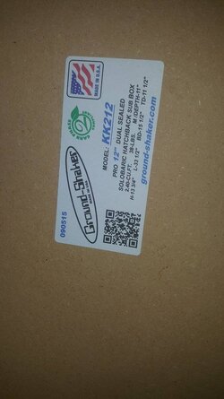

Thank you for the quick reply. i have the 4 door colorado variant. Would you say all 0 gauge wire is equal or should i pay more for better quality? And you are right the ppi called for 50amp fuse in the maual i found online. now this is the first time ive owned an amp with no onboard fuse let alone 2 and the manual stated that i run i fuse on the cable coming from the battery with all the combined amperage of every amp. so this basically means the fuse i connect next to the battery will suffice as long as i put a 250amp fuse in it or do i need to add a seperate fuse? You say the h35 isnt enough to run these 2 L7's which i find crazy since the car they came out of had 2 15 L7's lol, not saying your wrong just saying that its fuuny that they were underpowring those 2 15's lol. finnaly this is the box that came with the speakers and im assuming its okay, right? Thank you so much for your help and the reading material. Thanks so Much for the welcome Btw =))))
Not all 0 ga wire is the same.You want OFC Not CCA .High count in thread is important as well.there have been debates on which brand is BEST ect. reliable also.Sky-High makes good wire,Audio Technix has worked for me just fine.You are going want to use 0ga supply wiring.from battery to an ANL fuse of a min of 250 anl fuse then wiring to a 0ga FUSED distro block with a min of (one 0-4 ga in and tw 0-4 ga out) I recommend a dual ANL or Mini ANL fused block at the amps. You will need 1-200amp fuse for hifonics amp/H35, and 1-50  amp fuse for the PPI.I highly recommend you do the Big3 in 0 ga as well. You may need a second battery depending on your voltage drop.More than likely you may need the extra battery.Shaker boxes are not that bad but will work. Seems too small for a pair of those 12s sealed. You will get better response going ported for them from my experience with L7s(10s,12s, 15s) ive ran over the years and still have installed.Subs up port up do much better in my truck, and that is the way ive last had them installed.(working on a new wall now).Hifonics has gone down hill for me as i am a collector of Hifonics amps/Zed made grade VII,VIII series were some best made in my opinion. newer versions majority have been tested to not do rated of which you may want to do some reading and research for yourself depending on the model.Those subs will serve better in a built ported and well tuned enclosure rather than a store bought enclosure. But what you have will work, but dont expect tohit some serious lows or to sound amazing.
