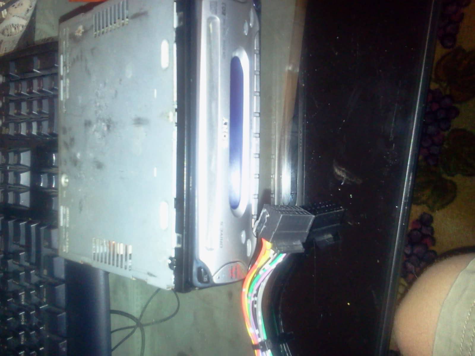

so if you saw, ive had a shit ton of hu issues this past week. it was the factory ground, it was all corrode and poorly placed on a this piece of sheet metal! secondly on the Sony HU. the ground actually broke off some how?...
so theres my cuplrits... toyota...ugh...
heres a tip,
check it once, then pull head out, check again.!
I've used the factory ground when installing aftermarket head units in the past 4 vehicles I've owned and never had a problem.
theres the HU's board. clean as day? ironic... i thought it blew...ground just went out..
