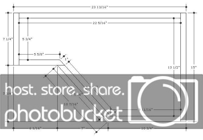

OK, example: This is the side profile of a 94-96 Impala SS enclosure for which I have built plenty in many variations for all different types of subwoofers.
Both the exterior and interior dims are noted and as most folks they would break up the interior into separate elements to determine the sq. in area as shown:
Each color block would represent how someone may break it down and determine the sq. in. for each doing the math, thus add it all together to arrive at the TOTAL sq.in.
In SketchUP, the same detail I can find the total sq.in. by merely using the Select Tool, right click the area, a window pops up and I select Entity Info and the Entity Info Tab pops open and shows me the exact Sq. In. of that detail.
Then I just do the math - Sq.In x Length ÷ 1728 = CU.FT.
However, if there are multiple Entity's that have to be done to determine the volume of a design, I created a calculator in Excel that does the math for me.
All I have to do is drop in the Sq. In & Length and the calculator gives me the cu.ft. for each entity and total them together to arrive at the TOTAL VOLUME.
