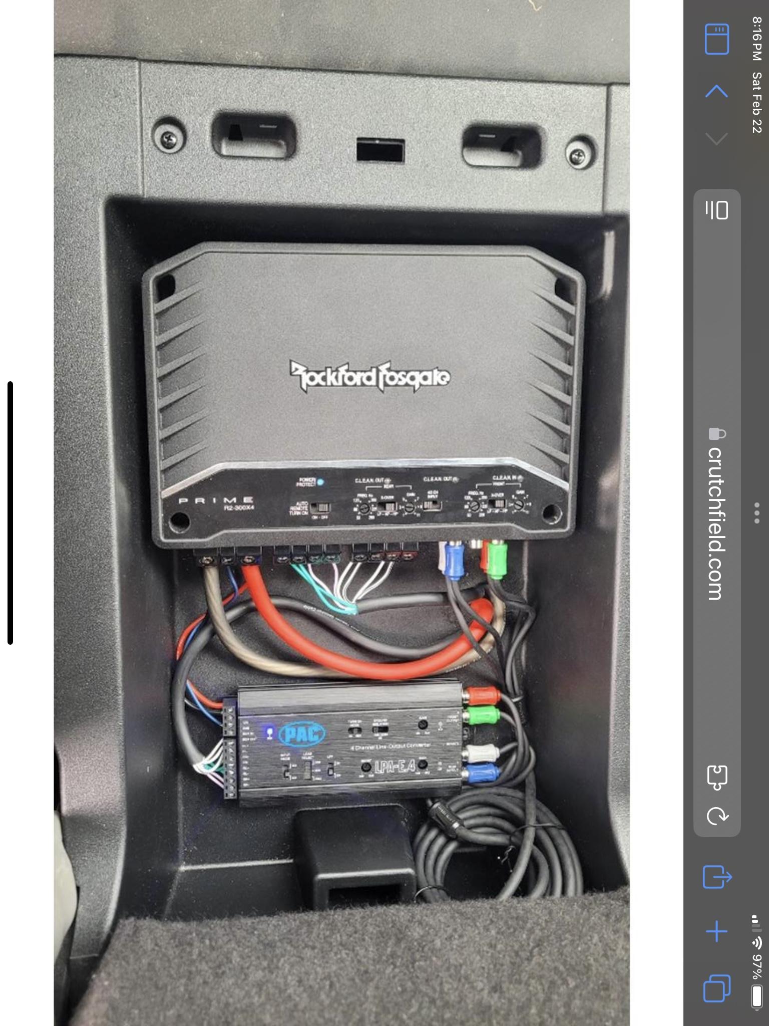

I have this photo. I believe that’s an LOC under the AMP. If it’s no trouble, what the hell alls going on here? Considering the LOC isn’t used. BTW I have two, two plug Kicker LOC’s. Something tells me if I needed an LOC dem ain’t it.

Sorry.
HPF means "high pass filter." It prevents lower frequencies from playing through your speakers to help prevent distortion. What size speakers do you have?
The speakers include a 6.5-inch midrange low in each door, a 1-inch tweeter in the "sail panel" in the lower-forward corner of each front window, a 3.5-inch midrange/tweeter in the center of the dash and a pair of 6x9 two-way coaxials in the rear deck.
