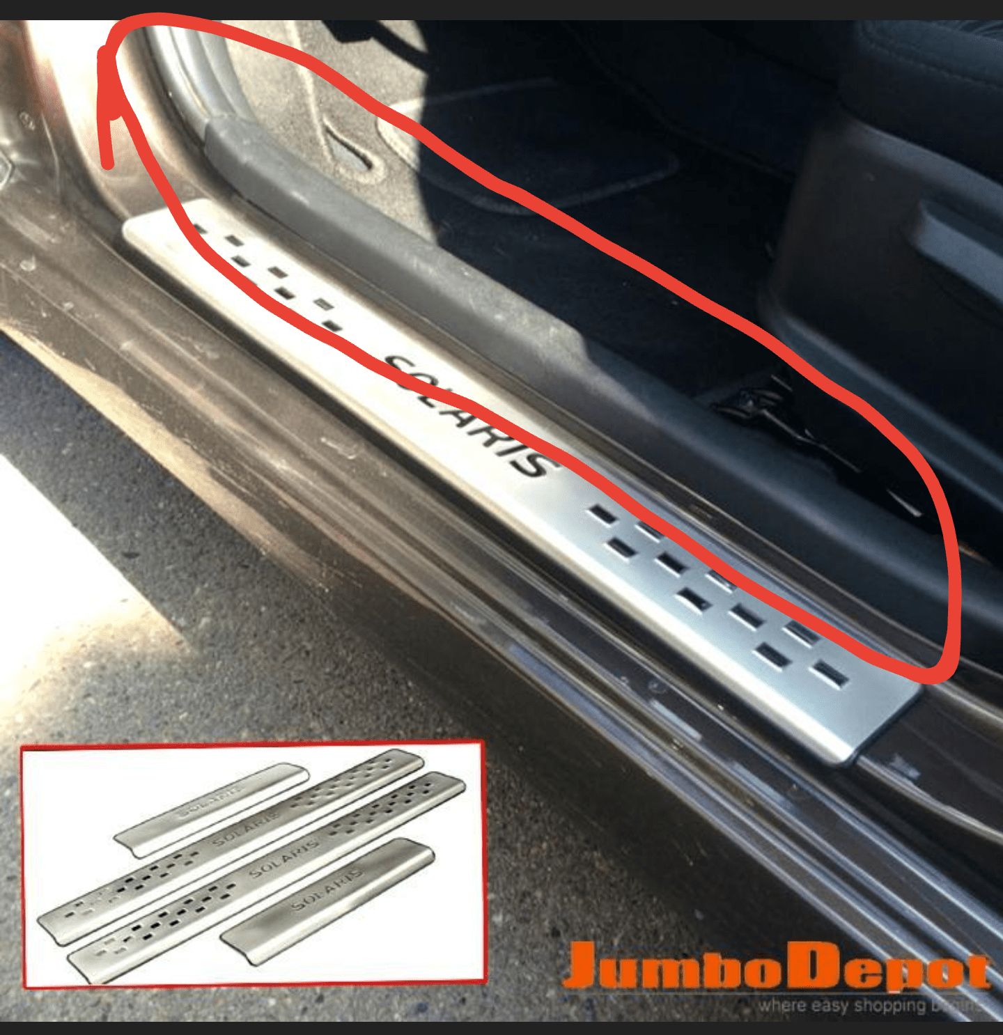

Answer1) By the door sill there is a plastic trim that can be pulled straight up. Underneath is a channel to run wire that goes all the way to the trunk.

Answer1) By the door sill there is a plastic trim that can be pulled straight up. Underneath is a channel to run wire that goes all the way to the trunk.View attachment 50185

yeah i guess its the left door trim. head unit to the bigger compartment right beneath the fuse compartment to the l. door trims.
