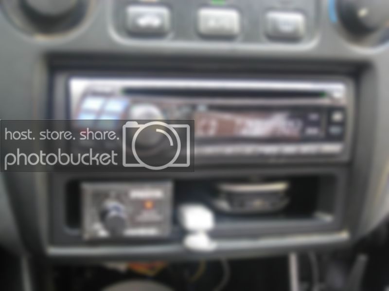

like this would help, but here

That center F button below the volume knob- does that center various frequencies? If so see what the bass is centered at and if it is boosted at all. I can't remember what that button was for...
