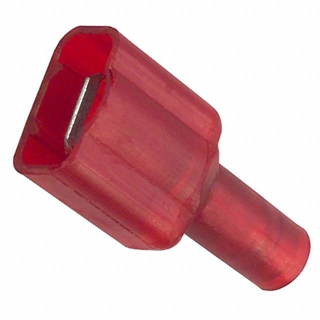

I was thinking of using insulated spade connectors with male and female versions. Something like these:
Where do I find the counterpart to that?
they will owrk but they ahve the same issue as the bullet caps. they stick together and the insulation comes apart or sometimes the wire will pull out. lol smart harness...i havent called it that in a long time. it will cost money but you will not have the headaches that you WILL have with the spades.
