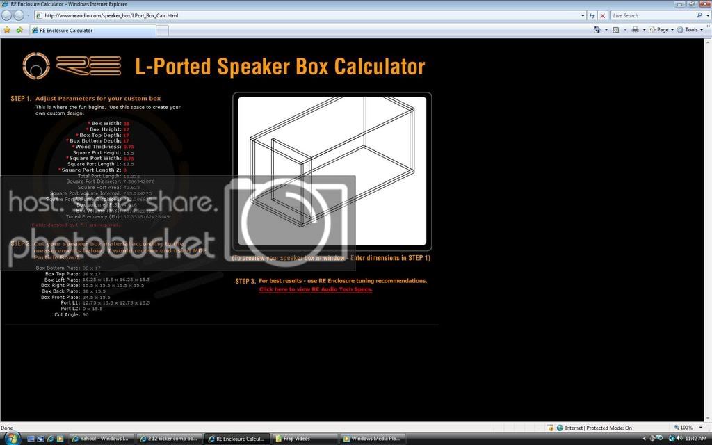

Came up with this box after reading various post on these forums. Looking to put two Kicker CompVR 12" in this box. Any suggestions or comments would be apprecaited. This is my first box build, wanted to get the specs right first before building away and find that the box is not to spec.
I was going for a box around 32 hz and little over 2.0 cub per sub for space reasons.
i used that calculator to build a box using the cut out sheet at the bottom and the port came out a little narrower than it said it would have, luckily i caught it. And it could very well have been my mistake but im pretty sure i cut it exactly as it said. any way just a heads up to double check before you piece together and finalize
