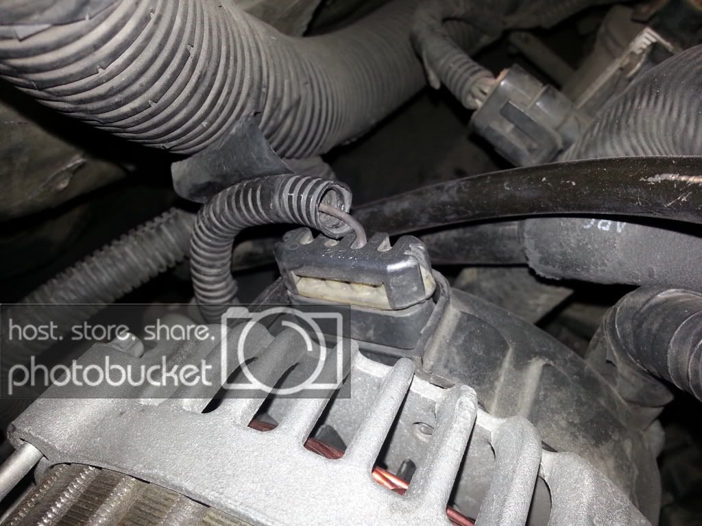

Heres my plug and wire lol I thought it was alot its only one wire in the plug..

No, one run to the front will be fine but I would go with more than 2 to the rear... If I were wiring it up personally I would connect the alts together locally (just a short jump from one to the other) then have one of them connected to the front batt with a single run, then 3-4 runs going to the back. If you connect the alts together it becomes all one circuit so you don't need to run individual runs from each alt to the front batt, one will suffice.
