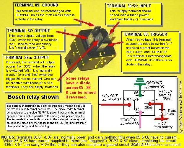

Hi guys,I just bought a relay switch from Ebay. I would like to know which wires goes with which to wire up 2 of my amps to avoid thumping when turning them on and off?

edit- I thought that picture was wrong, go off of this one

lol has nothing to do the the fusing or wattage of the amps, it doesnt hook inline with the power wire, it hooks inline with the remote turn on and yes he can do it, its only like .5amps for each componet to turn on
30 power from batt86 remote from deck
87 to the remote on the amp
85 ground
or actually what i do is hook 86 to the switched ignition wire for the radio

yes 30 is constant power from the battery, you can go to the battery or find something in the fuse box or tap into constant power in the headunit harness
you can put the relay wherever you want
86 i use the switched power in the headunit harness
yes 30 is constant power from the battery, you can go to the battery or find something in the fuse box or tap into constant power in the headunit harnessyou can put the relay wherever you want
So can I tap into the yellow lead on my head unit? Or should I use the Red lead which goes to the accessory terminal?
