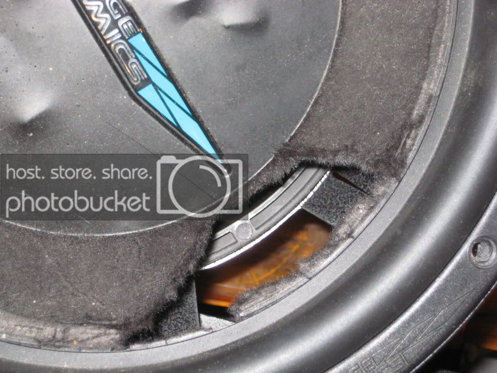

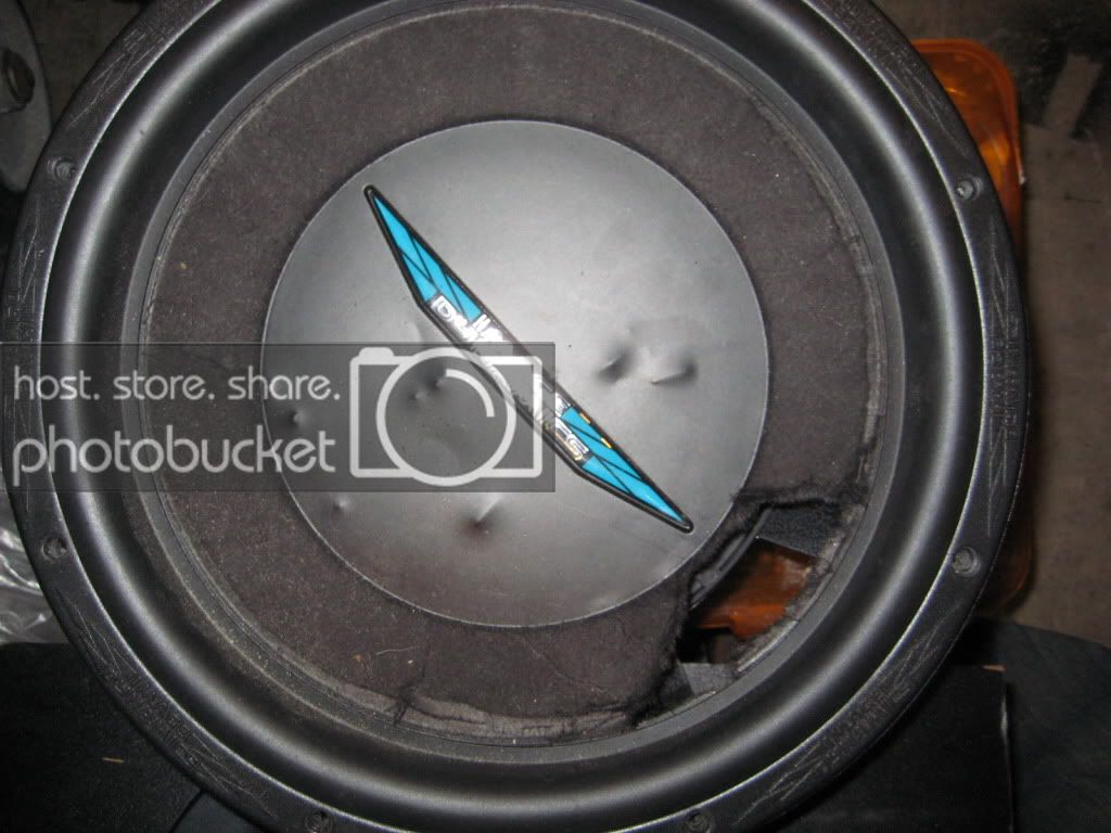

If it is on the surround, I recommend using silicon. I used silicon to seal a small puncture on my Nightshade and it held up perfectly. Also, I've heard that RTV gasket sealant (I believe that's what it is called?) works great too. You can get any of the two at walmart on the cheap.
There are the Pictures
aint nothing fixing that. and it will prolly get worse. the cone will prolly get slowly peeled from the surround.

recone
