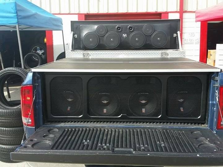

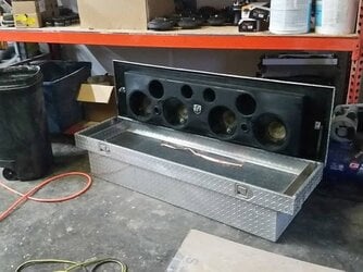

Put a toolbox on the truck. Mount the speakers to the inside of the toolbox lid in proper enclosure. Open tool box lid when when camping. Have amp on a switch and extra batteries in tool box.
