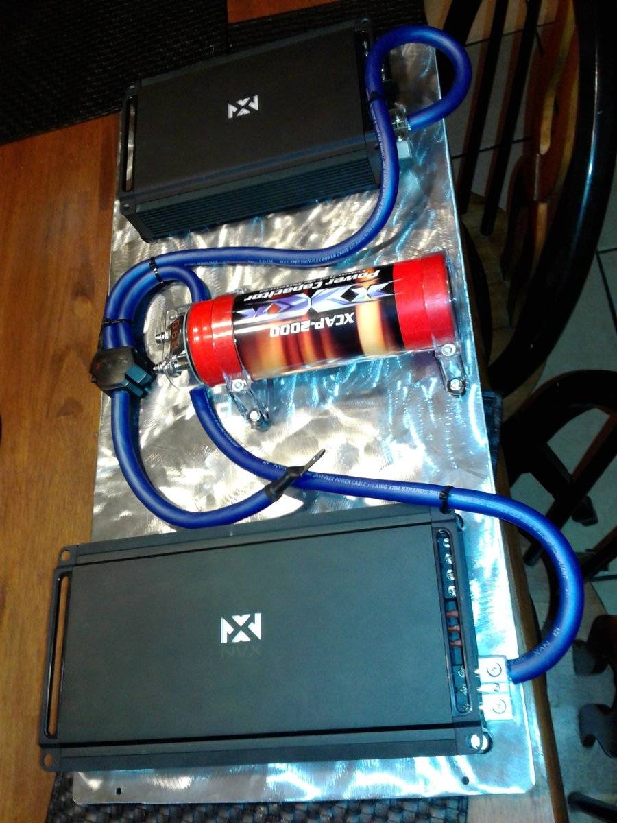

Have a xs power d 3400 battery. Going to be running class m 3/0 welding wire. 34awg strands. So pretty flexible. That will be running to the cap (rocksford 10 farad) only there to take a lil strain of battery on the deep bass hits. in the trunk for now and grounding with that wire. Then the 3/0 for the big 4 upgrade and then a 260 ho alternator. Max wattage my system will be seeing is maybe 4000watts rms. Then from cap dual 1/0 inputs two amp just for looks. Subs will maybe ever see 1000watt rms a piece as they are going to be in about 15% larger enclosure than specs.
