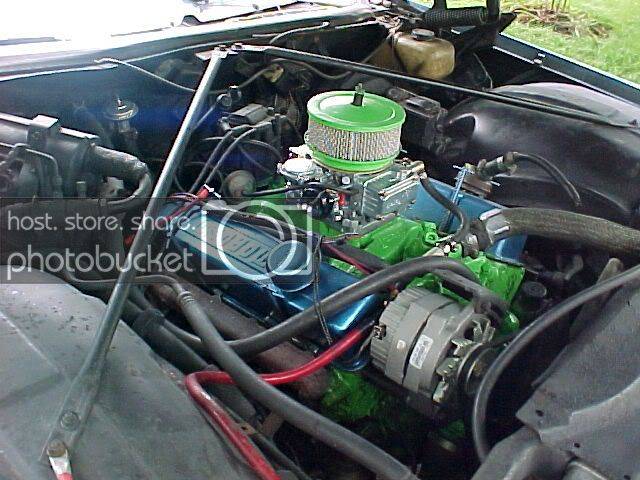

Trying to find engine black casting numbers. i think i have a SBC engine. i was told it was a 67 chevelle 350 engine. But that cant be true because they didnt even make 350's back then....im haveing hella trouble finding the casting number for the engine. where the heck can i find them. they said they were under the passenger rear but i still cannot seem to find it....and its erking me!!!

Hopefully these pics may help you help me.....thanks

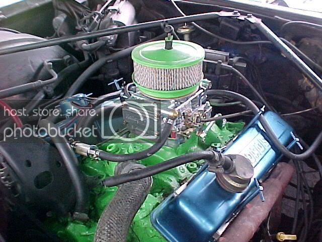

where could the casting numbers be located on this sucker?
Wow thats ugly.
Engine Code Stamping Numbers All engines are stamped with an engine ID code, consisting of assembly plant code, production date and suffix code. V8 codes are stamped on a pad just forward of the right side (passenger) cylinder head. 6 cylinder engines are stamped on the passenger side of the block behind the distributor

I did find my casting number. It is 3970010
which according to that page is either:
3970010 - 302 1969 Camaro Z/28 - 4 bolt main bearings
3970010 - 327 1969 2 bolt main bearings - trucks
3970010 - 350 1969 - 80 2 or 4 bolt main bearings
Also I Just Called the Previous Owner Stating that it was a "1976" Chevelle 350 Engine.....Must have gotten the numbers mixed...lol...idk but i think i do know now for sure its a 76 chevelle 350..
