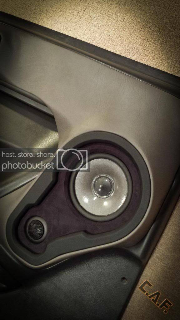

In this tutorial write up we will be covering how to create some awesome door panel pods that will add a custom look to your install, allow you to integrate multiple speakers into a door panel, and allow you to control the mounting position of the speakers. Note that while these are in fact door “pods” that are not actually permanently bonded are made as part of the door panel itself, there are many techniques within that could be used if you were in fact planning on creating door “panels” from scratch. Let’s begin!

With the mounting of your speakers and securing the door pods to the door panels you are done! Enjoy these pictures!
