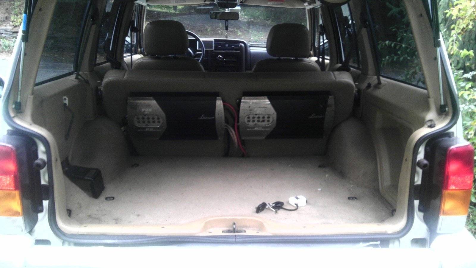

Here's the rear cargo area & both those amps are gettin replaced with a PPI BK1800 sub amp & a PPI BK800 4ch. Do u think I should face it towards the tailgate or firing upwards?

Should I just go with one of the 2 box plans I posted? One is 2.25 cubes @32hz, & the other is 2 cubes at 35hz...??
Maybe since this sub is known for hitting those low bass notes, I should go for th 2.25 cubes tuned at 32hz...??
