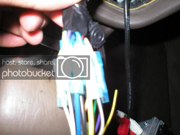

I currently have a Premier DEH-P550MP and am about to install my P860MP that just came in...the guy that installed my system before (when i was a noob) used a butt connector for just about every wire...is there any way i can reuse these butt connectors? and how do i get them off without destroying the wires (i wanna sell the 550MP later so i need this uninstall to be pretty clean...TIA...

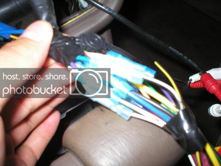

pics of the connections of the HU...and if i do indeed cut them...would u recommend cutting them on the HU side or the car side...??
so basically cut out the butt connectors...and restrip the car side of the wiring and twist/join the wires from the head to the car side sealing with electrical tape?
yes, but buy a new pack of butt connectors. //content.invisioncic.com/y282845/emoticons/wink.gif.608e3ea05f1a9f98611af0861652f8fb.gif I wouldnt trust wire wrapped in electrical tape
Or, you can get one of those DIY plug kits that all you do is strip the wires and put a special end on them, then stick the ends in the plug and connect the two plugs together. Thats what i did on my headlights, worked really nicely and everything is clean, plus it lookes like a pro did it.
They're called molex connectors, works wonders.
