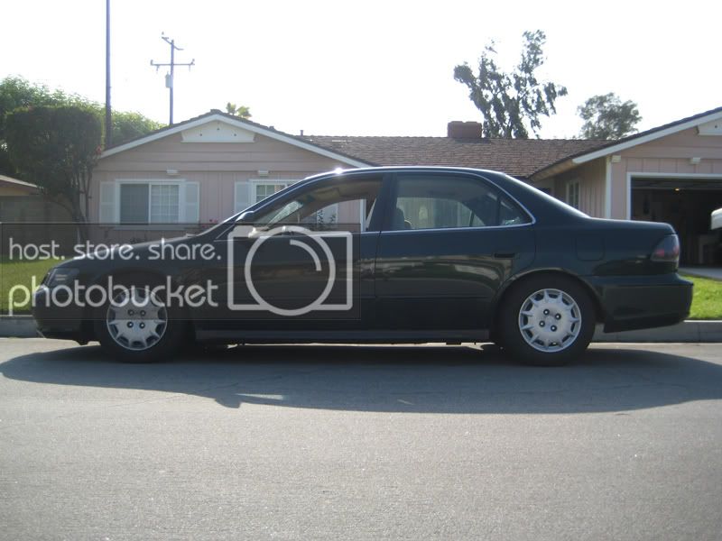

And for reference, here is the Accord when it was dropped:
As you can see, the amount of actual tire is MUCH thicker going from 30 to 35, but that has ALOT to do with going from 225 to 245 for the width since it is not stretched as much.
