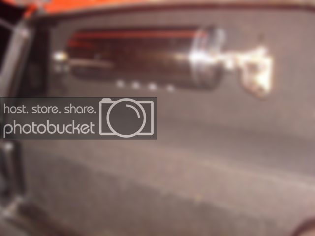

Air struts is about the only way to help the ride without having to weld stuff on. You'll need the struts, a 5 gallon air tank, varible pressure transducer, 40 amp relay, two SMC 3/8 valves, 40 feet of 3/8 air hose, and some misc air fittings.
This is how my Jeep is setup.
