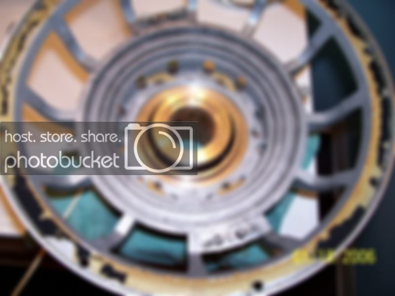

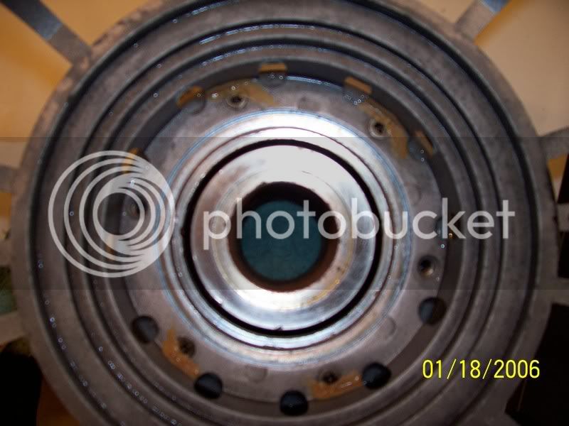

this is the disassembled SX12 btw.
see, same glue. even on top of the screws.
now look at the alignment of the plate and the gap, compare it with yours. your top plate is out of place and with the magnetic force holding the top plate that is why it's not shifting any.
//content.invisioncic.com/y282845/emoticons/fyi.gif.9f1f679348da7204ce960cfc74bca8e0.gif that is not gorilla glue. that is the glue they use on those speakers.when i dis assembled an SX 12 i had a long time ago it had the same glue, but as for the screws, they are givin a layer of glue above them so the screws do not come loose. you have to scrape the glue off to access the screws.
i have a 6 spoke basket from an early 04 XXX 18. it has the exact same glue around the top and spider area. i'll give you pics tomorrow after work.
your basket did not shift, why? look at the 2 other screw holes for the basket. they still align up to the mounting area. if the basket would have shifted, you wouldn't see those holes...
what it looks like is the top plate glue has come loose and shifted. i can clearly see the magnet in the gap, that means the bottom plate and all the magnets are still aligned. it's the top plate that shifted taking the basket with it.

Well, I pulled the basket off the motor, and the top plate came with it. So the top plate is bolted in to the basket. The tough part will be trying to get the top plate lined up on the ferrite slugs. Should I just throw some CA glue on the top plate to get it to stay on the slugs?
I guess the glue holding the top plate to the slugs more or less melted (lost its strength somehow), and the pressure inside the box moved the magnet enough to pinch the coil. Kinda funny that it pinched it just when the cone was at its peak excursion.
