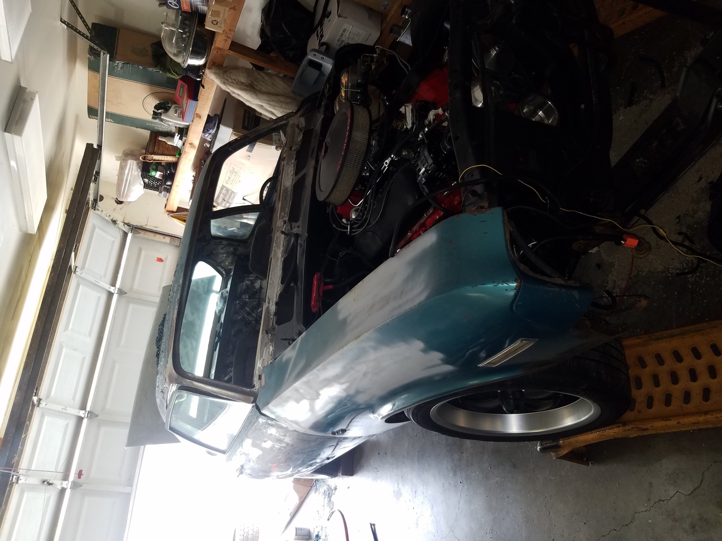

Yeah its getting there. I missed this summer cuz the motor and ***** had to get pulled from my other nova b4 i sold it. This car needs a lot of work. I had to learn how to weld. I already used 100sf of killmat for the floors and some of the trunk. I plan to pick up another 50 and just for the trunk. Working on getting a holley efi kit now.i plan to be able to back out my garage by spring if everything goes right...
