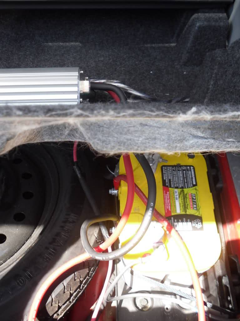

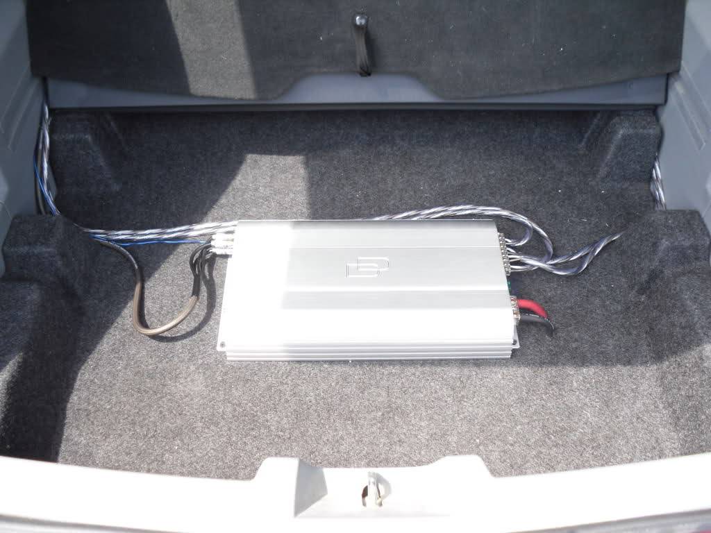

Here are a couple pics of my digital designs c4a....its going into thermal protection and shutting off after ~30mins of playing time at listening volume.....I am thinking it's due to the location under the "false floor" where there is really no air circulation. I added a pic of the wiring underneath because I want to make sure the ground isnt the cause of this problem....voltage stays at 14.1-13.9 while playing...
Lift it up .5-.75 inches off the ground and add a rotary fan off a relay, it'll stay cooler. The C4 puts out power //content.invisioncic.com/y282845/emoticons/fyi.gif.9f1f679348da7204ce960cfc74bca8e0.gif
Yeah buck I was just on my way to do that.....and btw u got a NEW email for that 18" design //content.invisioncic.com/y282845/emoticons/smile.gif.1ebc41e1811405b213edfc4622c41e27.gif
