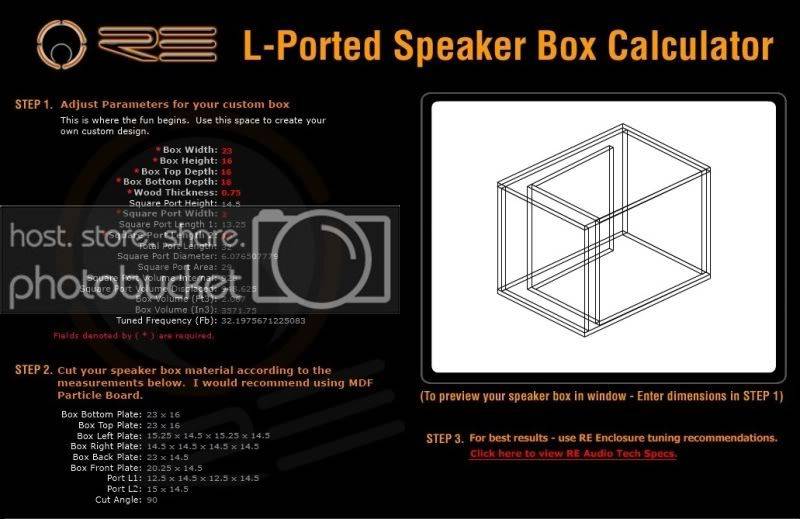

How does this box look? 2 cuft @ 32hz
aarunt1
:D
I made this box on RE's site. It is the desired dimensions and tuning I want. Just want to make sure everything checks out. I have the sub in my signature. Fi recommends 12-16 square inches of vent area per cubic foot of volume.
 The calculator says 29 which is 14.5 height x 2 width. Is this how vent area is normally calculated? I'm not sure because I have never calculated it before.
Anyways please let me know if this box should be fine. I don't want to make any mistakes making my box. Also, I could manipulate the box shape if need be. Is there any benefit or downfall of a square box over a rectangular box? I wouldn't think so but I figured it was worth asking.
Thanks!
The only thing I don't like about those box plans is that they do not account for any kind of bracing or sub displacement. In most cases that'll drop box size down a few tenths and raise tuning 2-3hz.
