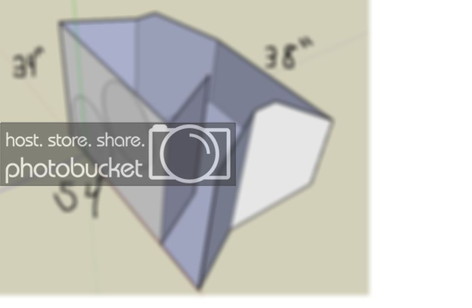

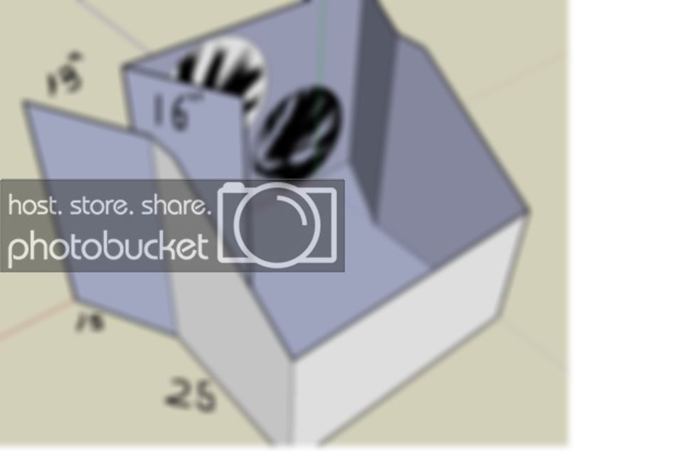

im doing a wall with 2 apxx 18's in my car. how does this look?
port is 31.75 tall X 12 wide X 16 long. should be right about 34hz.
the box in the front is 54wide x 34tall, and tappers back to 38 wide in 15". then it is 38" wide for 25". then the top is 34" tall for 20" and tappers down to 20" tall in 20".... kinda weird wording.... either way it should be about 25cf total. any idea's
would the port work well like this at the angle?
too big?
i got one in 13cf right now.... only 100sq" of port.
and yeah when you lower the port area the length will shorten.
16.7" for 34hz with about 340 sq" of port.
any input on the thing being to big? (thats what she said)
and will this port work fireing toward the drivers door? my doors already flex like a mother fvcker.
