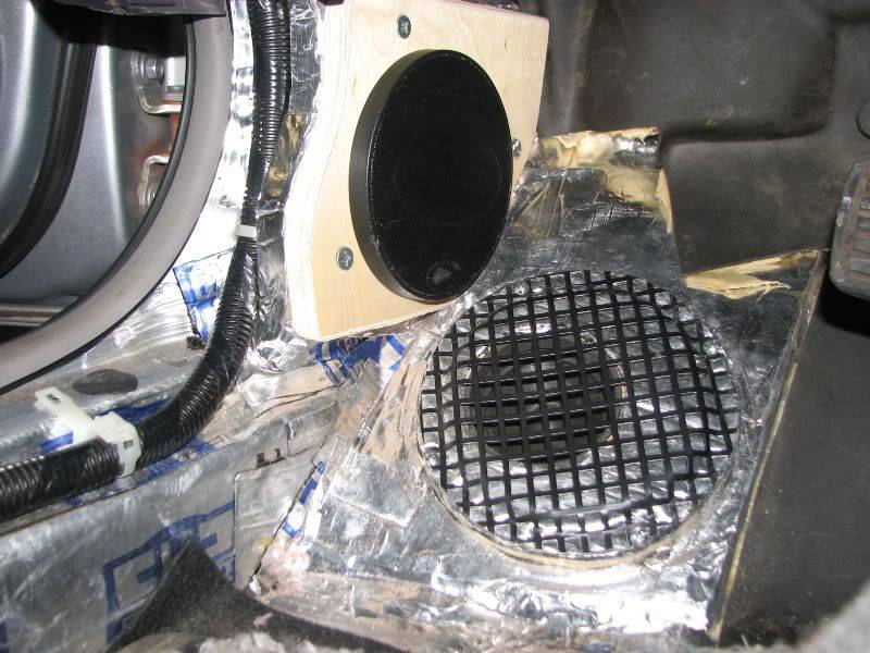

Pics of said kicks?
I had almost identical xover points at one time but the mids were in my stock door locations with midbass in kicks (scion tC) and I got more highs from the passenger side assuming since it was more on axis. It would really pull my stage down on the right side too since my tweets were on the dash.
Pics of said kicks?

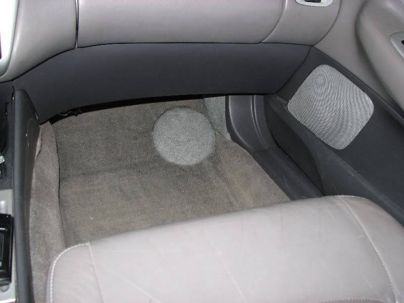

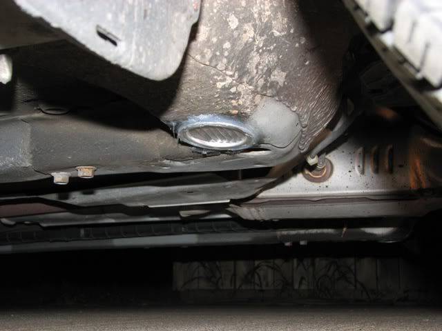

midbass is vented
my speakers have changed but locations and mounting is the same.

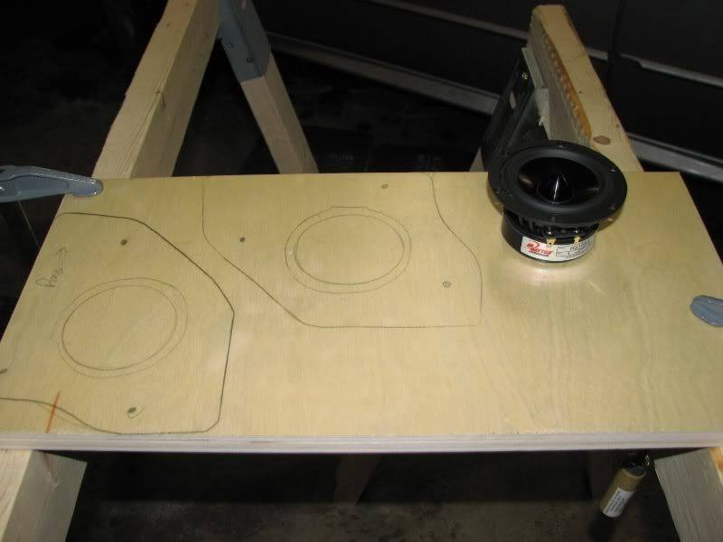

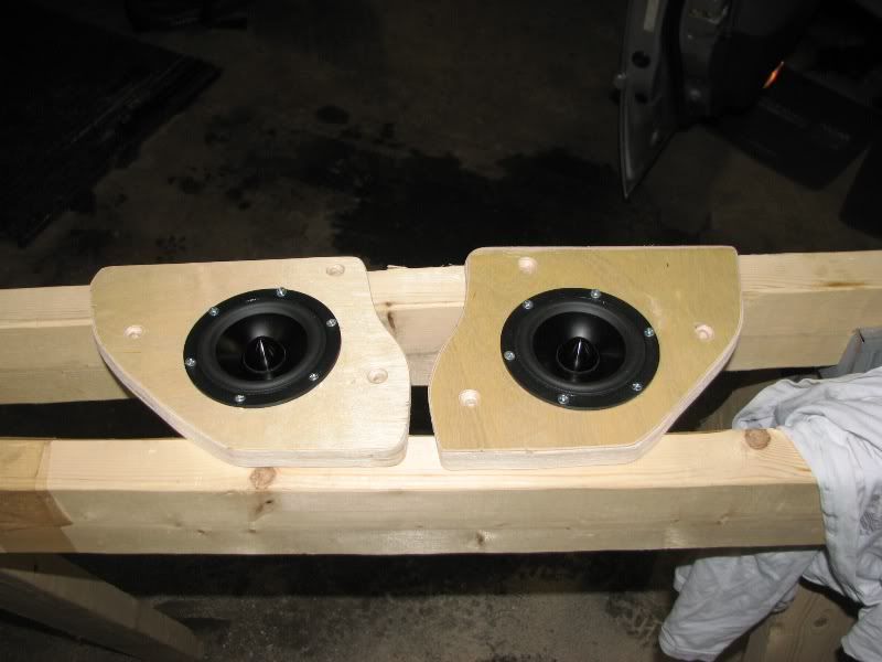

new mids are Dayton 4" - the side mid baffle is removable (recessed 1/4-20 t-nuts in the base) and here are two new baffles.

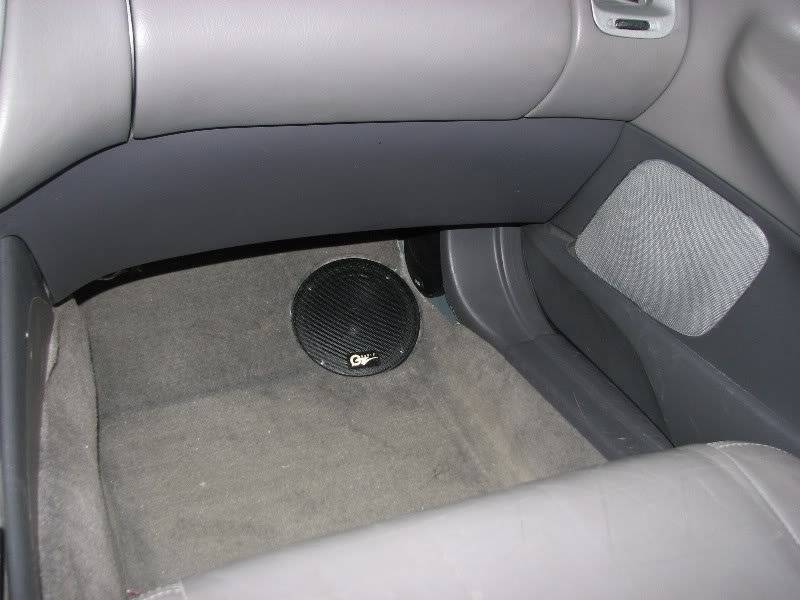

i tested side kick vs floor kick while my midbass was in the door. i recently moved midbass back to the floor so i could start on FG pods for new midbass in the doors - will be sealed door pod that replaces the bottom half and uses the existing volume for sealed airspace. should be fun.
this was during recent testing - i had a 4" mid in the floor, made an adapter to take the place of the woofer with waffle grill for strength. people commonly put there feet on the floor grill. on-axis response was great - well above 10kHz.
