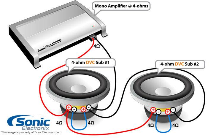

How can I wire up two Kicker 10cvr 124 subs to a Hifonics Brutus BRZ2400.1D amp?
Parallel each sub to 2ohms then series the terminal cups to 4 ohms.

How can I make sure I don't fry my amp when setting the gains? Also I was told to wire them like it says in this link,
. Is that correct?

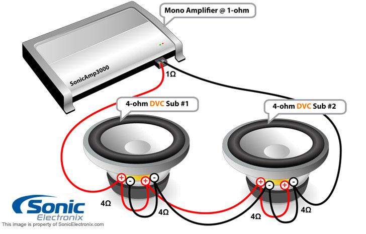

How could I wire up the BRZ1200.1D @ 1 ohm. I have yet to purchase so thank you for tipping me in the right direction!
Connect the positive with no dot to the postive with a dot on each sub, and do the same for the negatives. Now run a wire from the postive with no dot from both subs and connect them together, and do the same with the negatives and run those wires to the amp. Pretty much you want all the positives connected to each other and all the negatives connected to each other.
Should look like this
Kicker subs are different because the terminals are in 4 places, but you can tell which is which by seeing if it has a dot or not.
