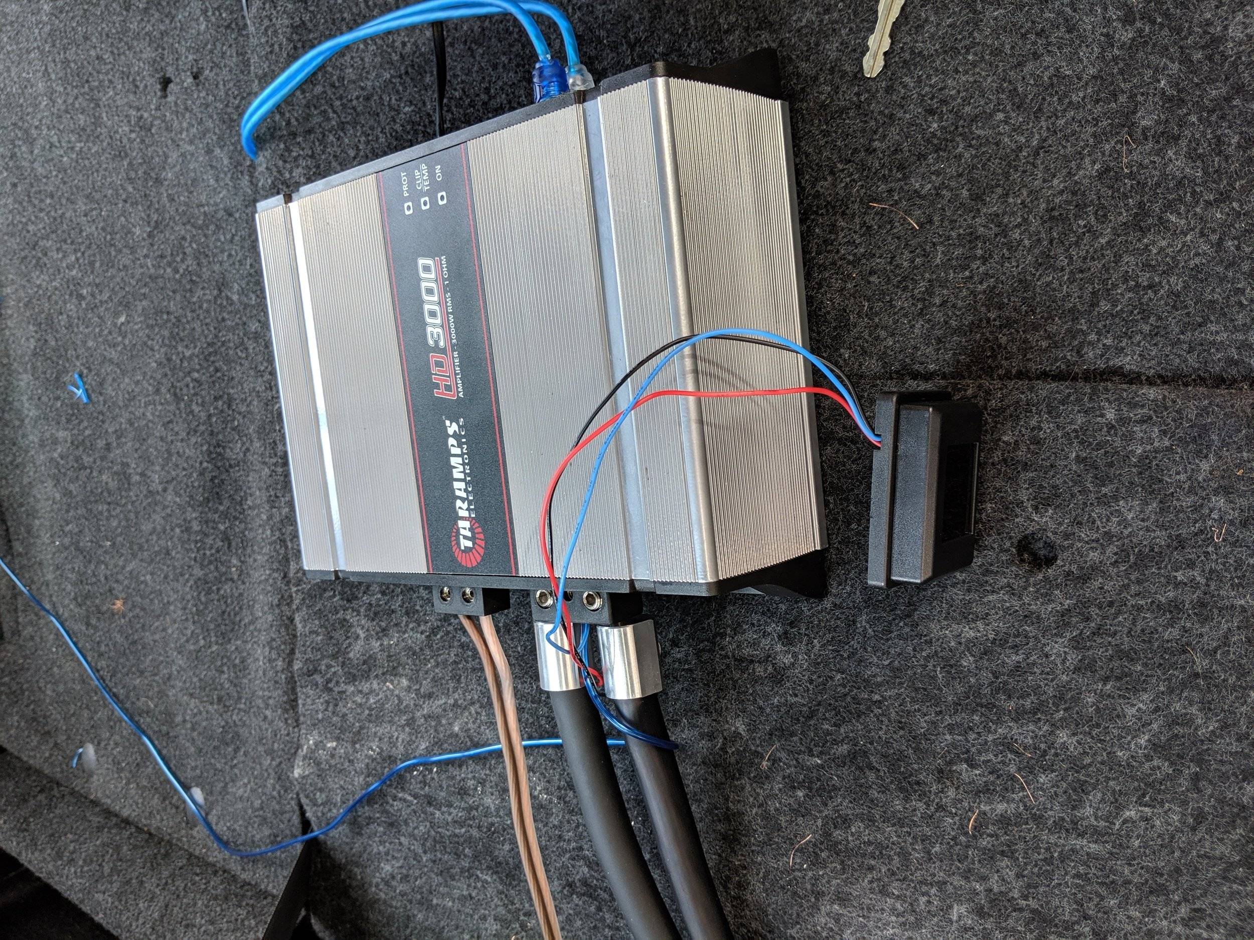

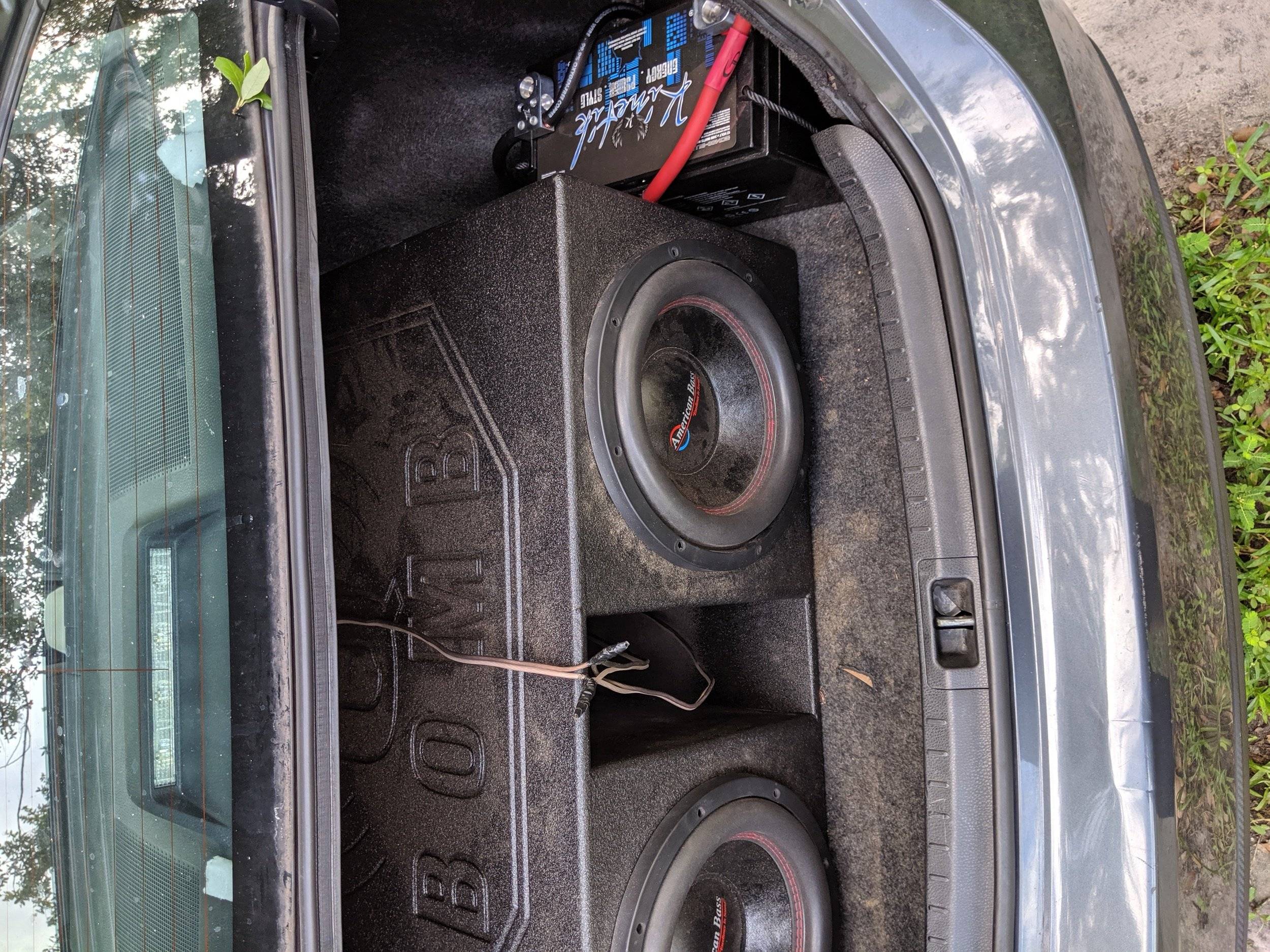

I have a 2014 Toyota Corolla that they don't make a high output alternator for so I had to do a second battery in the trunk with my little 100amp stock alternator.
Current system is: 3k rms taramps hd3000
2 12" American bass xfl dual voice coil 4ohm
Powered by stock alternator+agm battery under the hood+kinetik hc2400-blu battery in the trunk with all true 100% ofc 1/0 wiring.
Just have to turn it down if the voltage drops too much. Get a voltage meter for like $20
18213
18214
