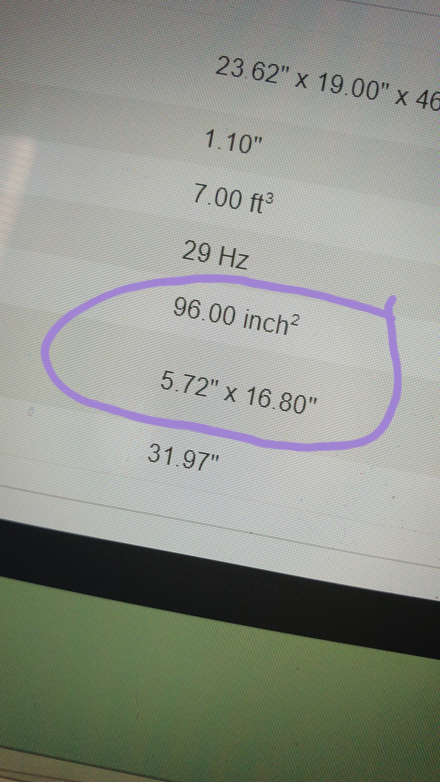

is this enough?

can you help me with this
You initially listed 112in2 of port for 7ft3 net... that is 16in2 per ft3.
96in2 in 7ft3 of net volume comes to around 13.7in2 per ft3.
If I was looking for sufficient port I'd model it, but if that's not possible... I'd say offhand again the 112in2 should work for a higher powered 18 in my exp.
The site recommends 5-6ft3 net, if you downsize the net volume a touch that 96in2 of port will be 16in2 per foot in 6ft3 net... this is really not the way to do this but as your planning to overpower/push it at times. I'd stay within volume recommendations and possibly undersize volume a touch if it was me.
