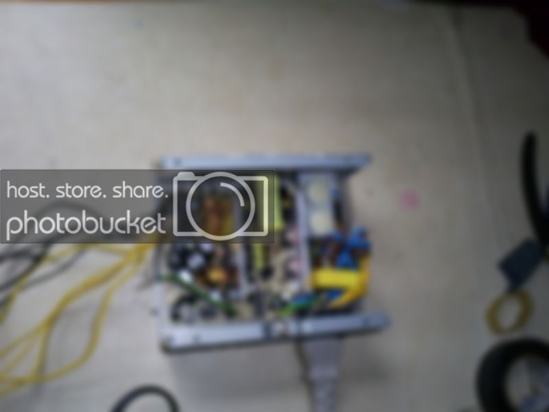

well, the PSU I have hooded up had dual 12V rails, totaling 58A. $45
my PC's power supply had three rails, totaling in 83A $89
besides, it's enough juice to make the Crunch amp wang pretty harg

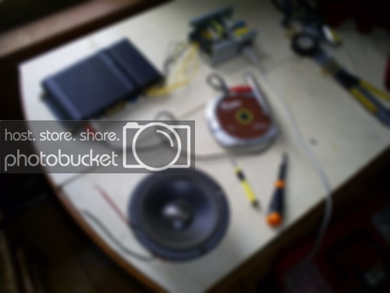

It works...
Thanks to Req for the help out on this...
I was surprised what I got out of this old school alpine amp. only 60 watts rms but it cleaned the dust off the cheezy pyle speaker...also tested it on a jl12w0...not bad for what it was...I think I'm going to try wiring two in parallel now since these are only 100 watts a piece.
