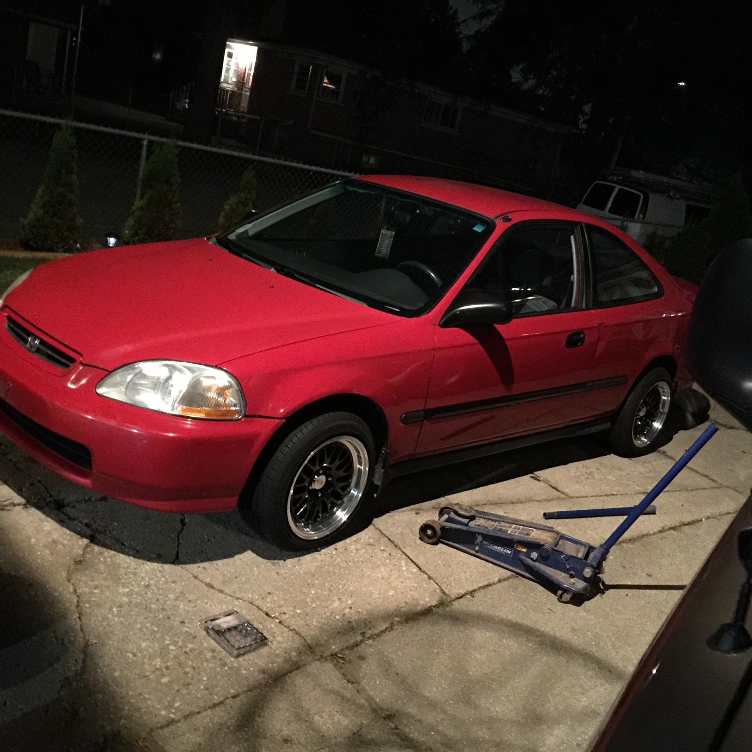

Here's my hoopty by the way - she's a work car but I can't help it , is always have to add a little style to my rides .
