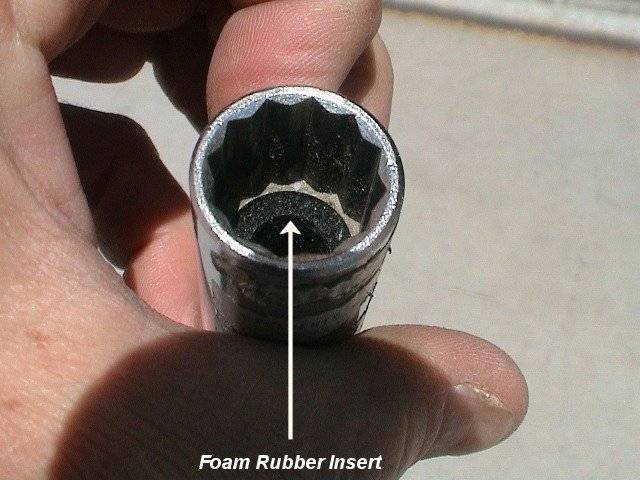

...you mean to tell me you can nigger rig something like that in a day, but have never heard of a spark plug wrench? here ill show u. The insert comes in it when you buy it. So no need to mess with anything. But a word of advice from experience, spray the rubber with wd-40 or whatever to keep it from sticking to the plug. /experience.

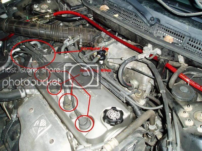

....*sigh*.... Well here we go: Spark plugs 101
You have spark plugs, we have established this as you have an internal combustion engine fueled by gasoline. Remove the wires going to the spark plugs. Stick your spark plug socket along with an extension on your ratchet down in the hole. Loosen then remove. Simple. When RE-installing plugs, stick the plug in the socket, and BY HAND tighten it until you cant any more, then attatch the ratchet and go 1/4 turn. AND NO MORE. you WILL eventually strip the thread if you continue to tighten it. BTW, a Haynes manual would be a bible for you. I dont mind writing up stuff... but there comes a point where ya gotta get some common sense lol. Its cool though. Makes me feel like im helping the community //content.invisioncic.com/y282845/emoticons/biggrin.gif.d71a5d36fcbab170f2364c9f2e3946cb.gif
