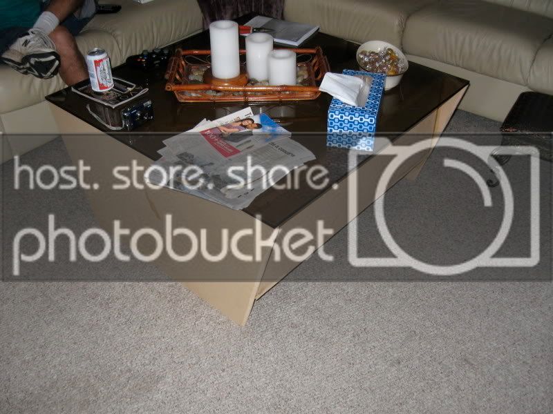

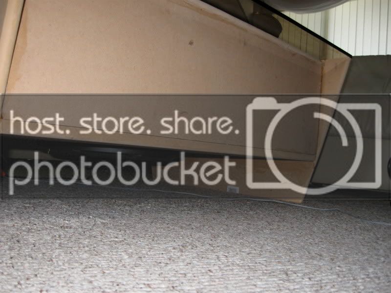

Here are some shitty pictures. I didn't get any during construction, but you can use your imagination.
That's a pretty cool coffee table box, although I'd imagine you could get significantly better response out of it if you placed it elsewhere in the room. Placing it in a corner could give you a dramatic difference.
How's it sound?
That's a pretty cool coffee table sub, although I'd imagine you could get significantly better response out of it if you placed it elsewhere in the room. Placing it in a corner could give you a dramatic difference.
How's it sound?
Yeah, I'm sure it would probably double output if I put it in a corner but it would look weird. Unfortunately, I went back to college before the amp arrived for it so I only heard it on about 25 watts. It sounded decent, no large dips or peaks in response so I was happy.
