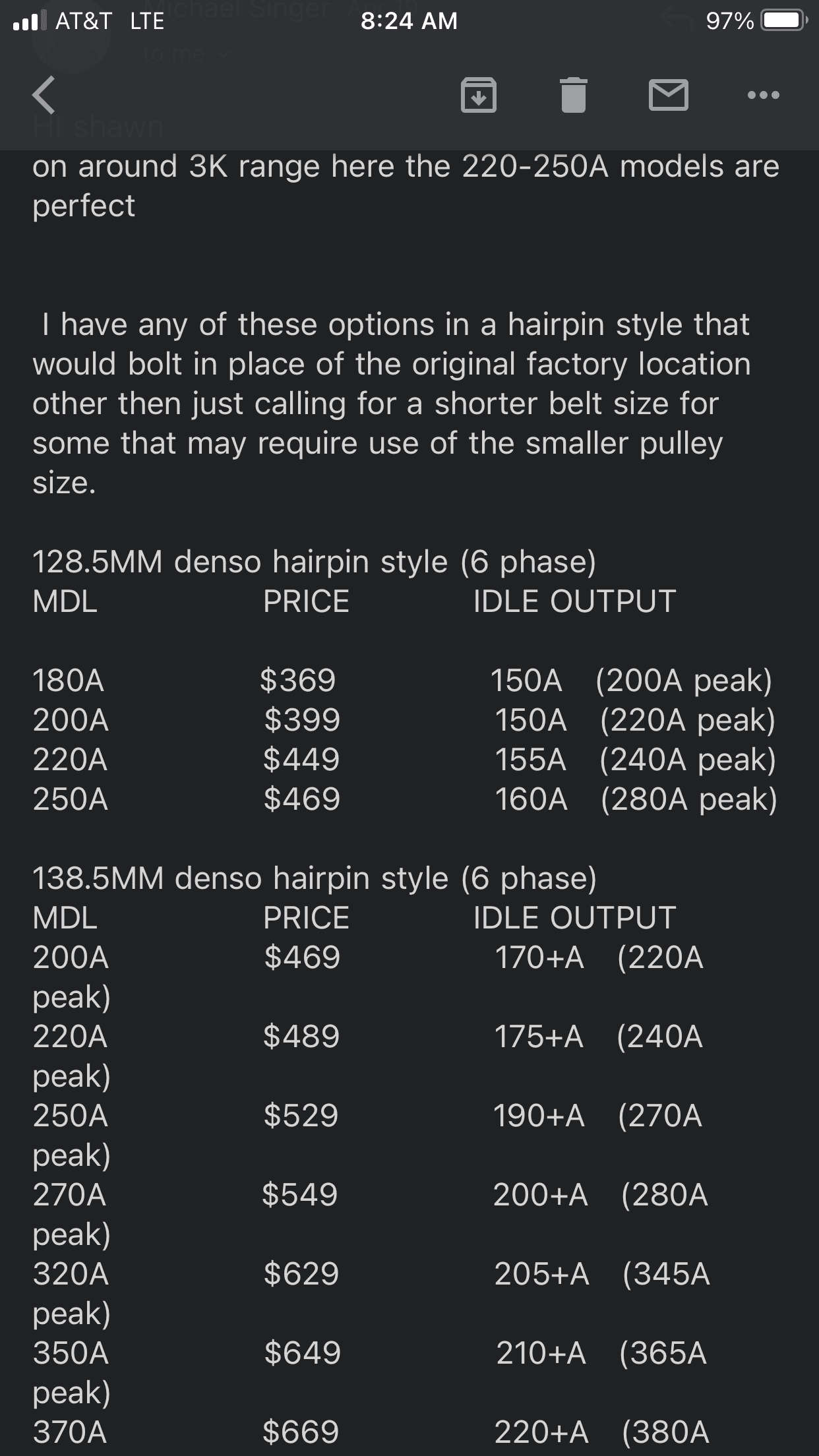

So I’m going to be getting a HO Alt for my 2009 F-150 (4.6L 3 valve). Mechman has a 240a for $399. I reached out to Singer and have a list of options but would likely stay from 220a $449 to 240a $469. I will need a new belt and possibly a smaller pulley both day. Any experience with this engine? Also, which would you choose? I’m leaning Mech for the price. Both have been super responsive and great to talk to.

This the email from Singer

Anyone have experience with 4.6 and know which belt and pulley I need?
Usually the recommendation that is included in the box is .5 to 1 inch smaller. They last 2 of his alts i've installed i've bought 2 belts (one belt .5 inch shorter than OEM and the other as close to 1 inch shorter as possible) and then I just return whichever one of the 2 I don't end up using.
