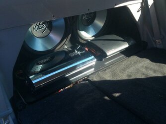

My set up is 4 speakers, front and rear, subwoofer, an external Amplifier in the back trunk, aftermarket head unit.

An older Alpine amp

You have a ground loop issue mate!. Please check your grounds and re-tighten them.  Also check if your speakers are not in contact with the vehicle chassis as well. if unsure, apply electrical tape / sound deadening around the door speakers if not done already.  My money is its poor grounding point on the amp / vehicle chassis. :suave:
