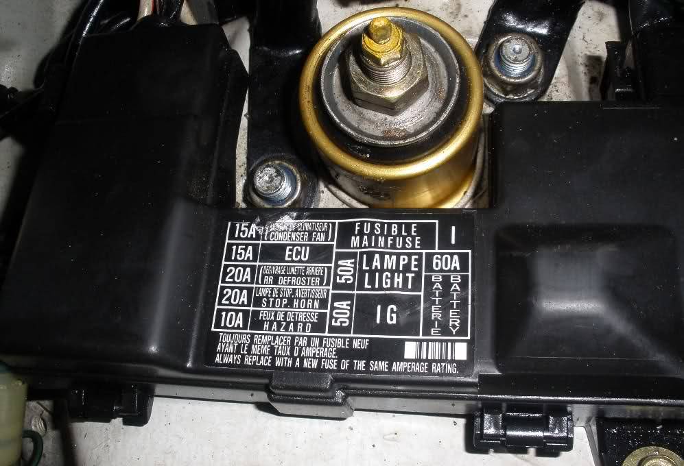

Hi guys, Im gonna be installing my 170 amp alt in my 1990 civic si.
My stock alt is 60 amp with a fuse of 60.
Is it necessary to change the fuse with a higher 170 amp fuse in the fusebox? ?

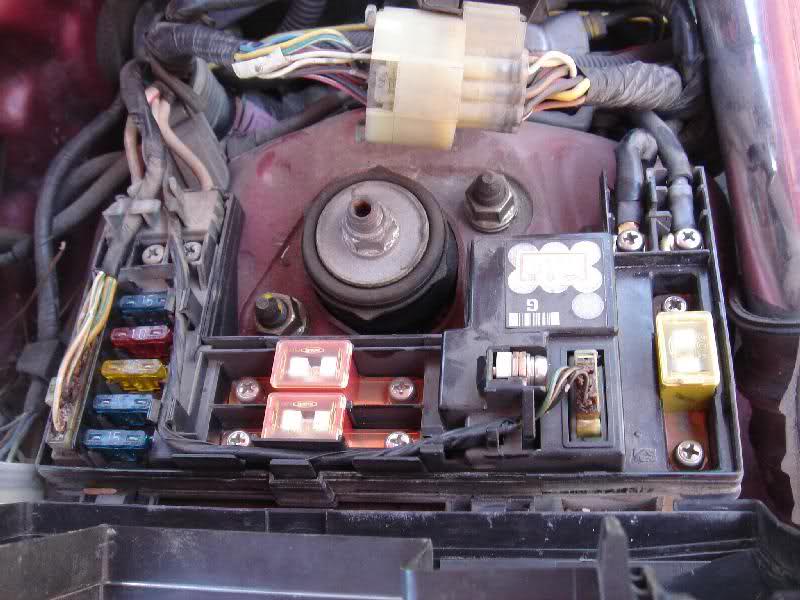

heres a reference pic of a civic underhood fusebox. Which one do I replace ?
No fuses need be replaced, run a 1/0 cable from the alts charging post directly to the batterys pos post (as in doing the big 3) and fuse that wire to its max amperage handling (normally 300A for 1/0)
Your stock wiring will not hold up to 170 amps, you need at least 2 gauge.
I was told 4 guage is fine for 170 amps.
Im still a lil confused.
If I run a new 0guage or 2 guage wire to my positive battery post from the alt, what happens to my old wiring and fuse ?
I was told 4 guage is fine for 170 amps.Im still a lil confused.
4 gauge is only good for up to 150A, and leave all the stock stuff alone, just add on to it.
