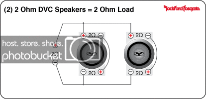

i have a hifonics bxi1206d and 2 12 cvrs d2s i have it all in gettin ready to turn it around but before i do i have a question k the amp is suposed to be 900 rms at 2 ohms an the sube 400 a piece and its in a built box ported with around 4.2-.4 cubes tuned around 40 hz 37-42- somewhere in between and sube are wired to a 2 ohm load or i wired em to a 2 ohm load but anyway the amp i have to turn input on it to about 7/8s and the bass boost on the amp ( no remote) all the way and then the low pass is arond 100 hz wtf is wrong here its 900 rms i shouldnt have to turn it up past 1/2 at max help please
are you sure u wired it at 2 ohms and not 8?
This is how it is supposed to be wired
cant see pic pm it to me i have it wire to bolts on the box ill make a diagram it might look like shit tho b caz i dont have an laptop right now an i **** with destops
