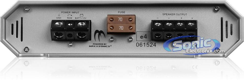

This is what the connectors look like if you're not familiar, they are designed HORRIBLY. I don't know who decided to put them at an angle like this and make them so small but they must be retarded.
