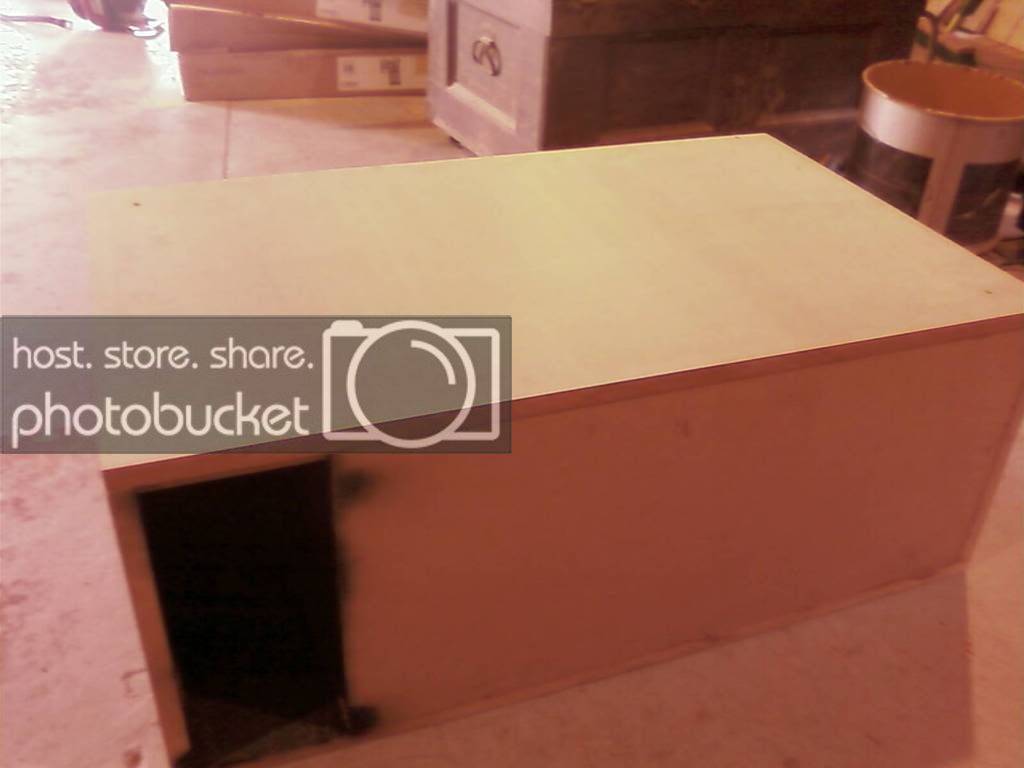

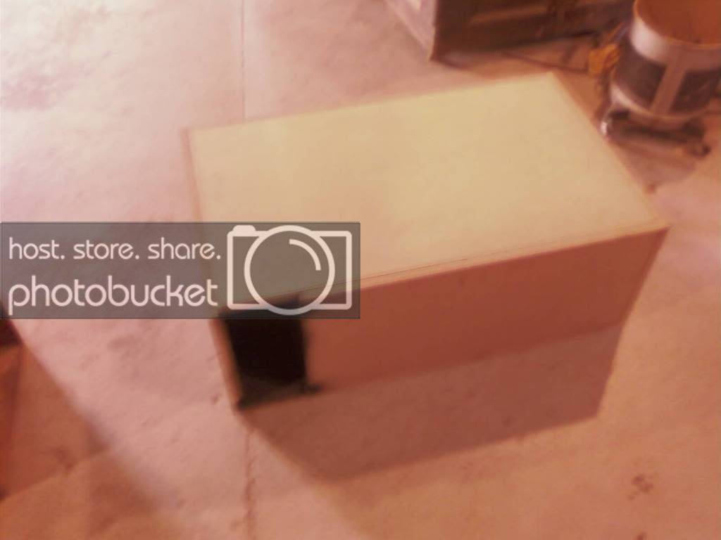

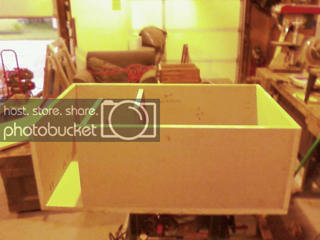

ia dp 15coming soon to fill this off a 2500d, box is 3.9 cuft tuned to 33 if all is right //content.invisioncic.com/y282845/emoticons/smile.gif.1ebc41e1811405b213edfc4622c41e27.gif
the port looks wrong cuz the way itll be double baffled, 1st piece will b flush with the 2nd capping the entire top

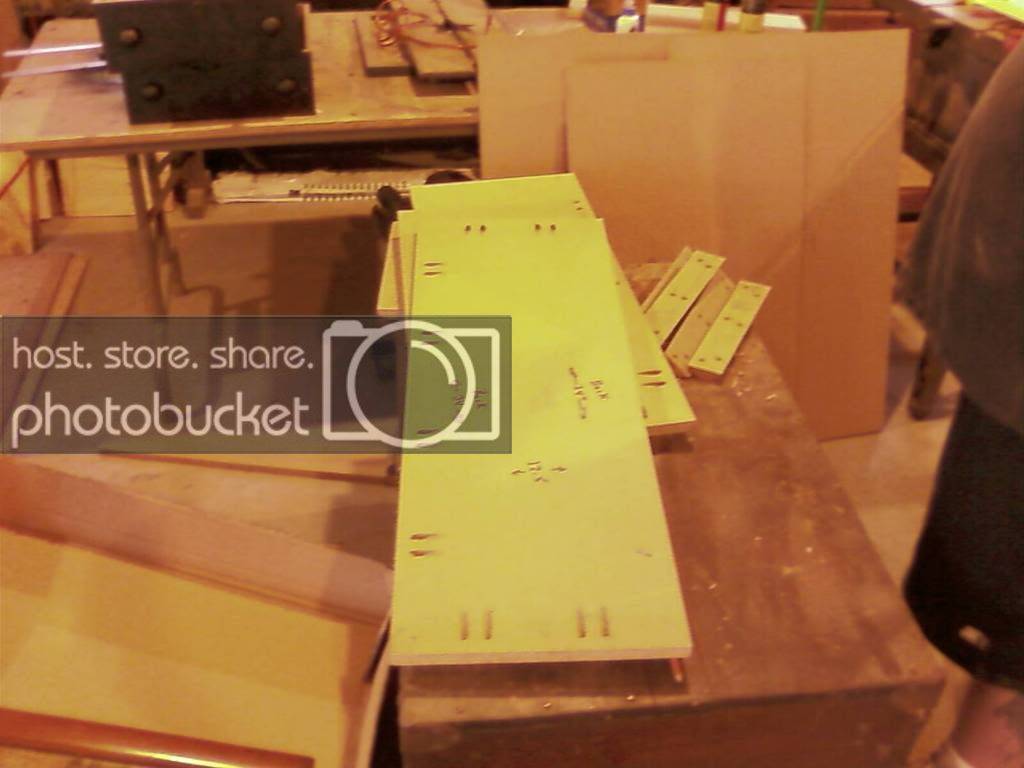

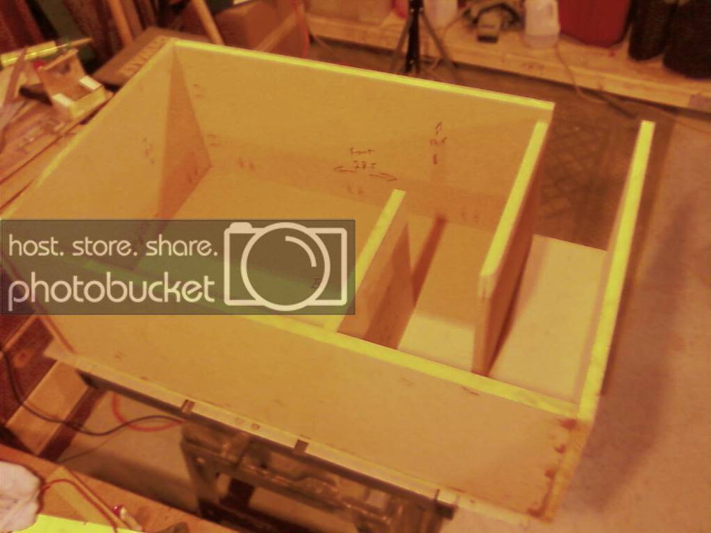

pocket jigged around the inside, so i can use minimal screws on the outside. i plan on filling them in w/ glue and saw dust. my 45's too

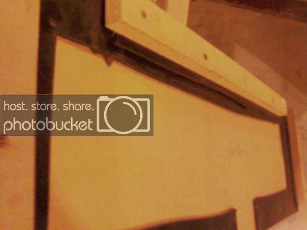

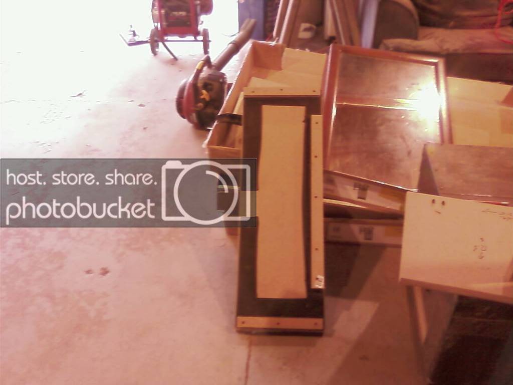

backside of my amp board, the black is 1/4" rubber

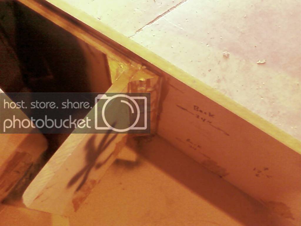

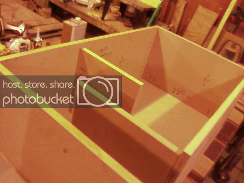

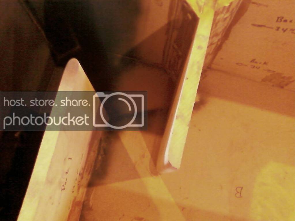

port area, the extra piece at the "u" or the port is to keep my dimensions the same (5.5all the way thru)
other side of port

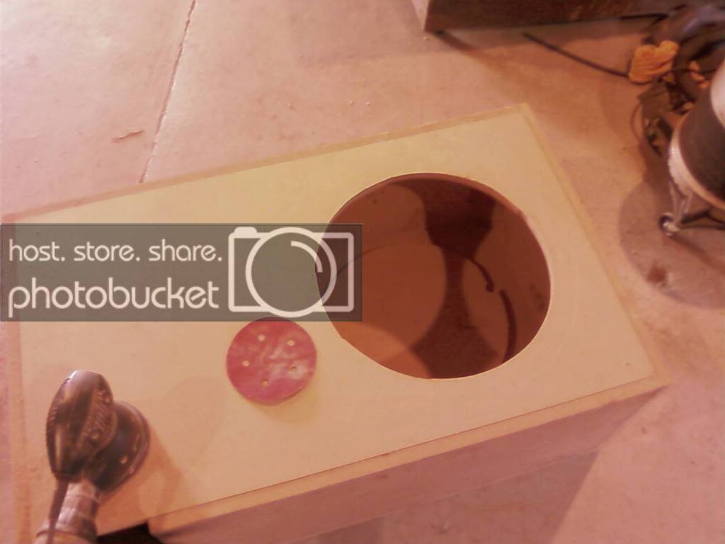

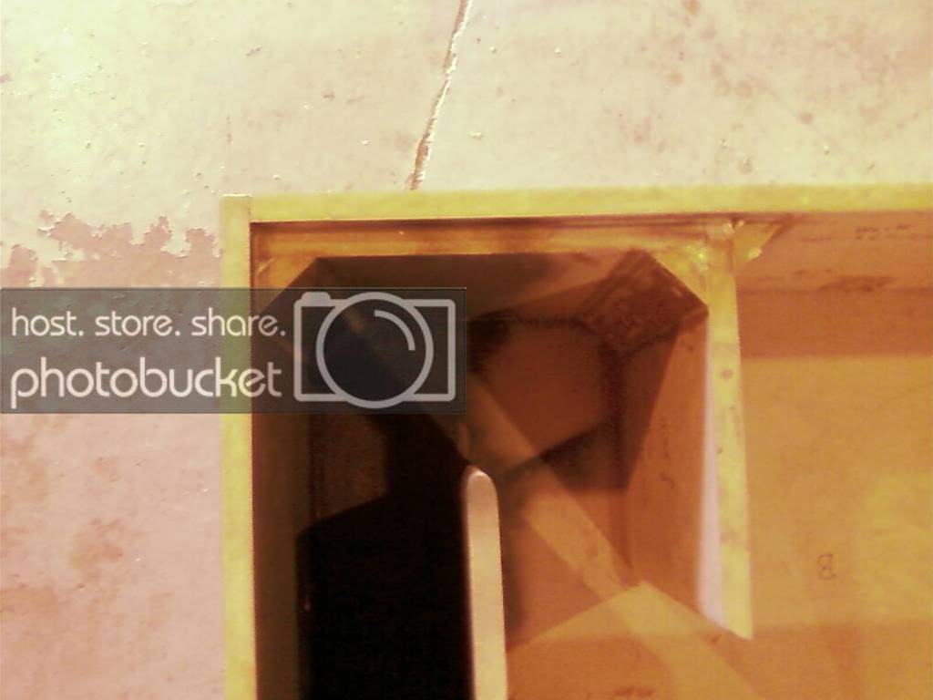

flush top test fit
2nd baffle test

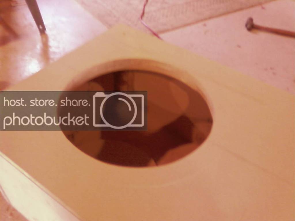

hole 1
hole 2
