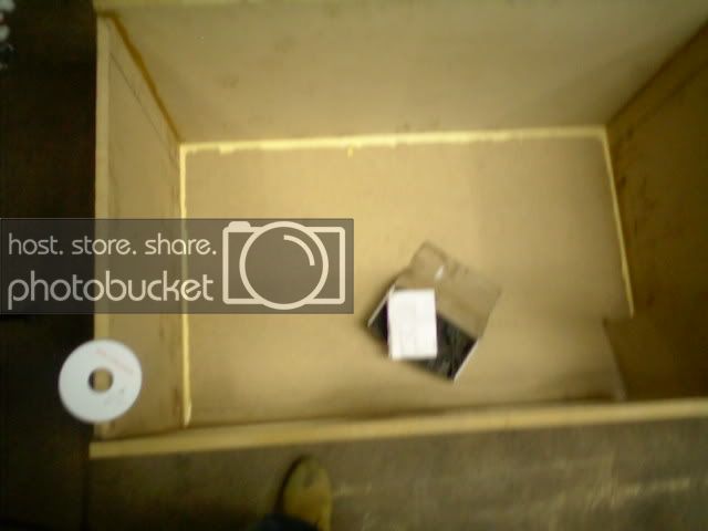

heres my box, i'm almost done.

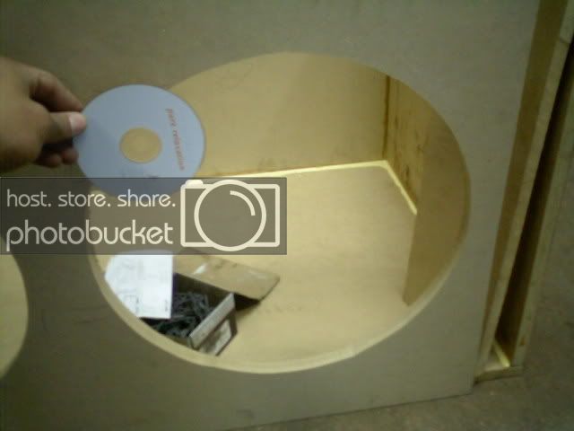

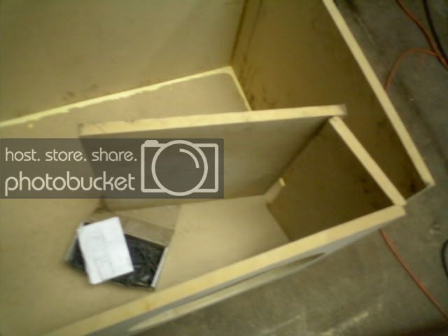

The port looks extra small if you ask me.But its sposed to be 32hz

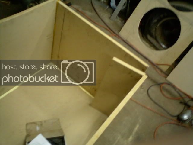

Now i'm not sure if i want to add in this extra piece right here are not, if i do i have to cut it at an angle because the subs depth is more than my ports length :Doh:

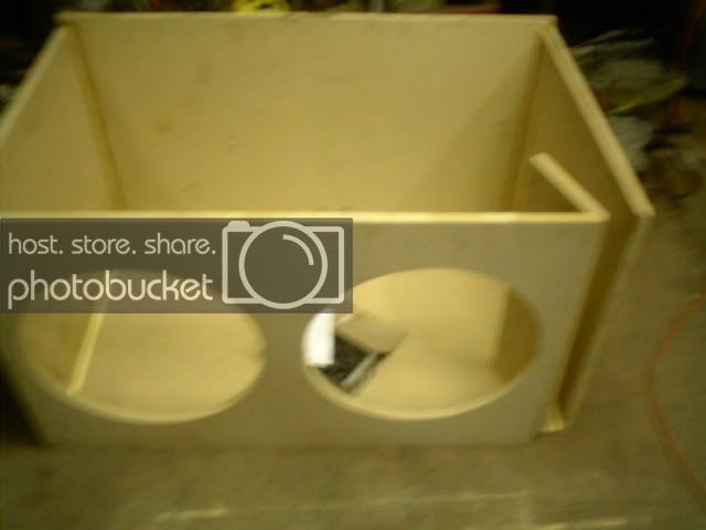

does she still need bracing, or should i still wait
HAHAHAHAHAHAHAHA
I think you got your port walls backwards. The longer one is probably the first one and the smaller one attaches to it. Any ways can you say hella port noise and improper tuning. Well at least it looks like it from the pics...
its not screwed down yet, btw.
But no its not backwards, the shorter one is supposed to be thier.
The one is supposed to be behind the sub though, but like i said the 1st port is to short so, i think i'm not gonna use it.(the one behind the sub that is.
its not screwed down yet, btw.But no its not backwards, the shorter one is supposed to be thier.
yea. thats totally wrong.
the longer piece goes first, then put the shorter piece second.
unless you want it to sound like crap. //content.invisioncic.com/y282845/emoticons/laugh.gif.48439b2acf2cfca21620f01e7f77d1e4.gif
According to my notes that is right, and using the port calculator..
height of 25 width of 3.5
The lenght of the vent should be 6.8 something.
tuned to 32
edit:
Basiclly the longer the port, the lower the tuning
