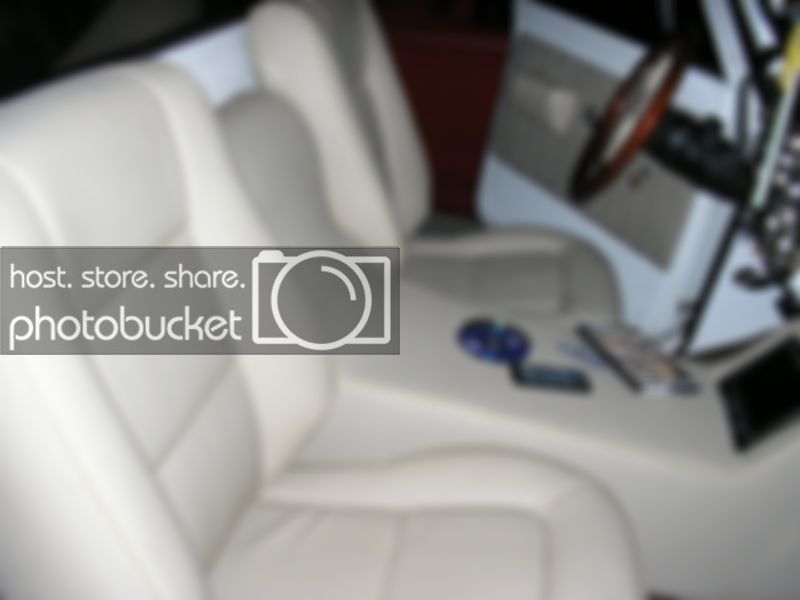

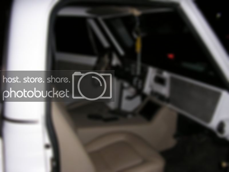

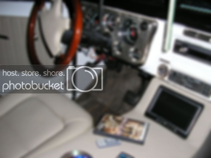

I can get some pictures of my buddies when I get home... It won't show much, but it will show how he did it... His is sealed and molds up under the dash where a screen is mounted. I have pictures on my computer at home.
Ya mine are from a mercury tracer. THey are leather too pretty comfotable. And very small.
