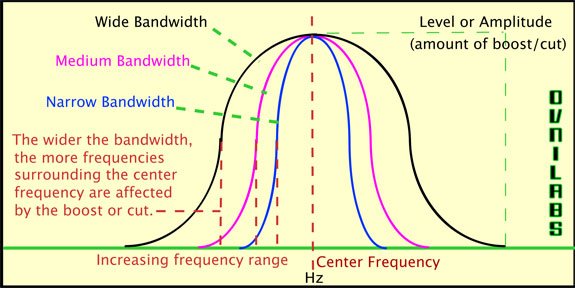

Here is a picture of what those 3 knobs will do. They can be useful if you have a hole in your frequency response but it should be uncommon in the low frequency range in a vehicle. I personally don’t like to use bass boost on an amp and would keep them all turned all the way counterclockwise. To really properly use it you should start by looking at frequency response inside the vehicle using a real time analyzer.

Here is a picture of what those 3 knobs will do. They can be useful if you have a hole in your frequency response but it should be uncommon in the low frequency range in a vehicle. I personally don’t like to use bass boost on an amp and would keep them all turned all the way counterclockwise. To really properly use it you should start by looking at frequency response inside the vehicle using a real time analyzer.View attachment 22676
Its better to figure out phase cancellation issues or address enclosure design flaws, box location/orientation over using boosts for a dip in their frequency response which usually leads to blown equipment most of the times.
