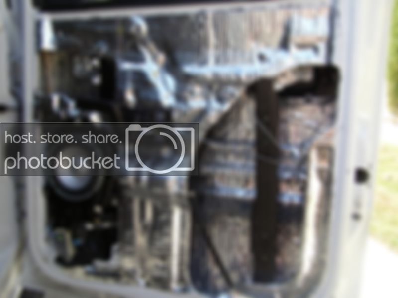

Closed off the biggest hole today. I used perforated aluminum thin enough to mold to the crazy door.
Then I covered the inside and outside of the panel with raamat and screwed it to the door. Seems pretty solid.
I think I will cover the rods in some ensolite.

img0238zm4.th.jpg'%20alt='img0238zm4.th.jpg'>
My doors
Bawhahahah....glad to see someone else had to suffer. Maybe the picture is deceiving but at least you can cover the holes with flat panels. I'm gunna work on them some more tomarrow so hopefully have some updates to post.
