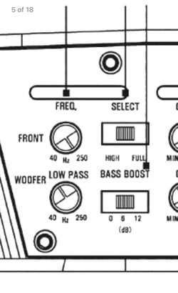

For my hgt559bt
I am confused
For the x cross
The manual says lpf the amp has
High marked
Is that the same thing?
Also
The manual says on full
The
Full range is bypassed,
Shouldn’t that be for bypassing the x s cross and leave all frequencies?

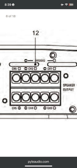

And also do i connect my 165s to ch 1 and 2 tweeters to ch4. And 5 and sub on ch5 correct?
What they call rear is dor tweeter and high sounds?
Also number 12 when it says to plug subwoofer does it mean 4 speakers ans 1 subwoofer?
(I hope so)
Sorry but im confused

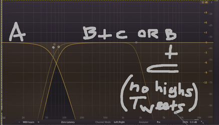

Here is a visual, with a reference of eq I want to set so you can see
can you tell me if this is the correct settings for the x over I want (nothing exotic) ?
Also is it better to use the mid range frequency speakers (B here) on the REAR outputs to have the possibility of the band pass 50-2.5khz ?
High marked
When set to High Pass, the Frequency you select will be the lowest that will go through.
The
Yes, that seems like a typo to me as well.
(I hope so)
No, Channel 5 is always exclusive to Subwoofers. When the manual states on step 12 to "connect sub to this terminal", it meant the terminal in general.
Edit: If you have two more 165mm speakers, you could plug them in Ch. 3&4.

apparently usually front is for tweeters and rear for mid speakers because on the right of the device near rear there is bandpass for those.
But i still dont know where to put four speakers in ch1-ch4’ s 8 outputs
Front is channel 1 rear is channel 2
They are the two channels being crossed over.
Channel 3 and 4 or not included in the x-over?

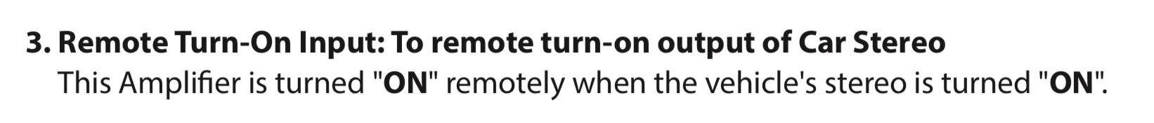

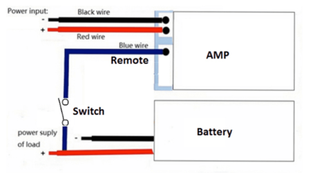

Does this amp react like this?
Some newer amps don't need a remote turn on wire because they can sense the signal coming from the head unit thru the RCA inputs on the amp.
Yes, when you use the on board x-overs, you can dedicate the front channels to highs and rear channels to mids.
As most amplifiers, each channel can run in 2 Ohms. You can put two 4 Ohms speakers per channel wired in parallel. In your case 4 tweeters in the fronts and four 165s in the rears.
Usually channels 1&2 are fronts and 3&4 are rears. If the active x-overs permit, then I guess you ccould reverse the roles.
From the provided pictures, I do not see a switch for that option.

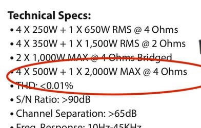

Another thing in the manual what happened for this line to have so much power?
Is it ok to send 250w rms to a 80w rms 4 ohm speaker?
